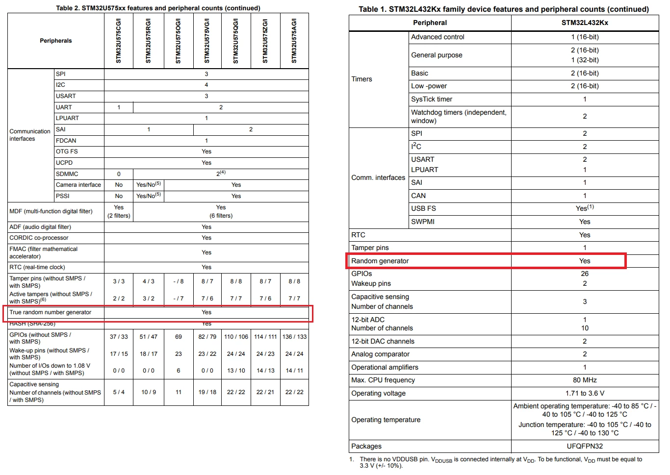

I want to use random number.
But, the same random number is generated each time it is run.
When I debug the code below, W change with the same pattern every time I debug.
What's the problem and is there any solution to make random number which is not depend on the order?

I'm using 2 kinds of board for i2c.
One is U575ZI-Q for master and the other is L432KC for slave.
The two devices feature RNG (random number generator) as shown in their respective DS:
You can inspire from one of the examples of RNG. Example:
https://github.com/STMicroelectronics/STM32CubeL4/tree/master/Projects/NUCLEO-L432KC/Examples/RNG/RNG_MultiRNG

What product you're using so you can use RNG peripheral instead of that "rand" library?

Need to seed it better.
Is there a clock or anything behind time() ? There'd need to be some association with the RTC and it would need to be running.

I didn't use anything according to the clock.
Is there any recommandation to make better seed?
srand(time(NULL)); <----------- I think it change seed every single second

That supposes time() is working and there's anything making it tick.
In embedded you'd actually need to facilitate this.
You should confirm that it is working as you imagine.
