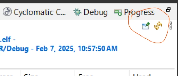

    Have you refreshed the build analyzer? Sometimes it doesn't refresh on its own. Rebuild and click the refresh icon:
