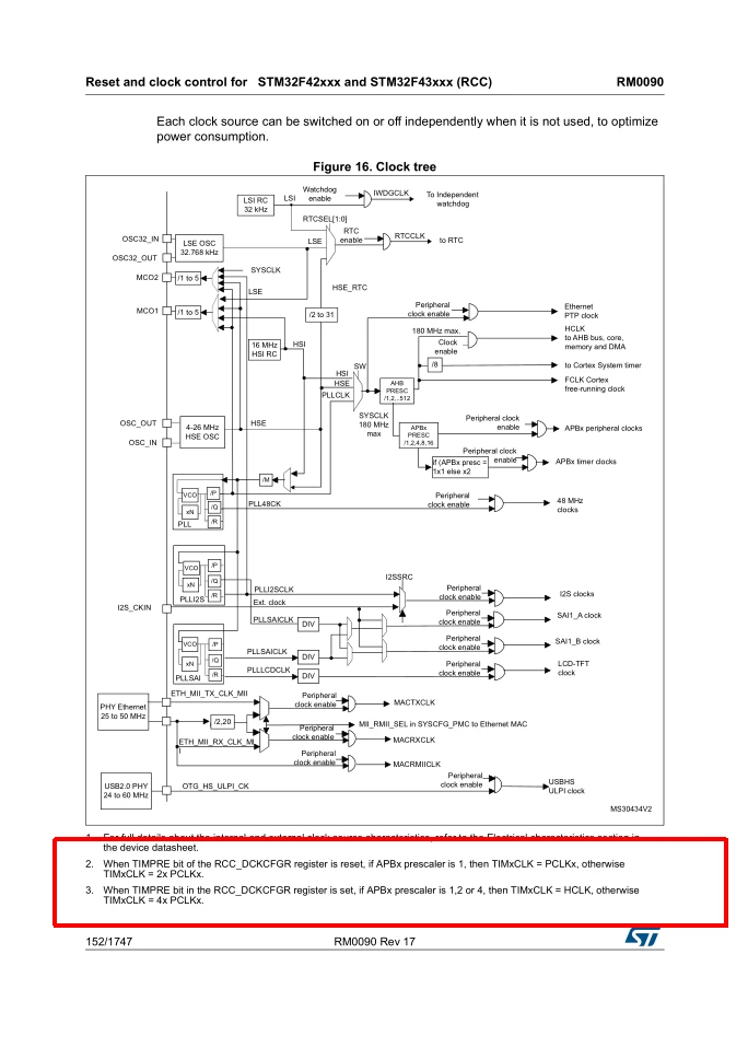

PWM timer frequency double of the expected/calculated
I'm working with a STM32F439ZI and want to use the PWM outputs of timer3 & timer4. I want to set a frequency of 50Hz (m_dat.fI) as an example. If I calculate it with the formula below, it results in a frequency of 100Hz instead and I'm not sure why, can someone help out?
PSC is set to 27 for both timers. and PCLK1 is at 42MHz
PCLK1Freq = HAL_RCC_GetPCLK1Freq();
TIM3->ARR = (uint32_t)(((double)PCLK1Freq / (double)m_dat.fI) / ((double)TIM3->PSC + 1)) - 1;
TIM4->ARR = (uint32_t)(((double)PCLK1Freq / (double)m_dat.fI) / ((double)TIM4->PSC + 1)) - 1;

    Timer's clock is twice the APB clock frequency, if APB divider is not 1.

    The divider is BYPASSED to allow higher clocking speeds on the slower bus. New STM32 families also allow the clock to come from different internal sources.
    Don't use RMW forms on TIM->SR to clear interrupt flags, just write the inverted bitmask to SR, it will occur in a single cycle, not 4-8 APB cycles.
    Use
    TIM1->SR = ~1; and not TIM1->SR &= ~1;
