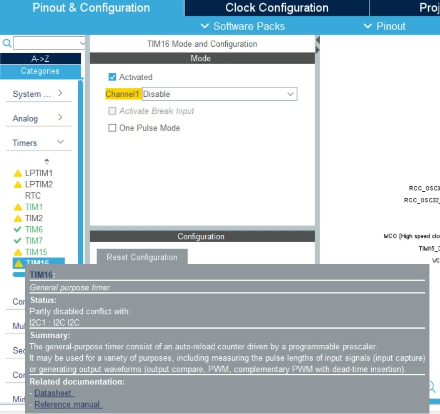

I have a problem with PWM. I need to change TIM16 to TIM15 because TIM16 collides with I2C

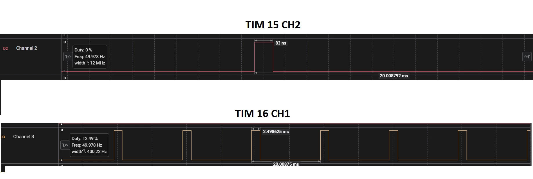

So thats why I have to use TIM15... I need him to handle micro servo. When i use TIM16, everything works, the pulses and the duty cycle are correct, but when i use TIM15, unfortunately the duty cycle is still 0

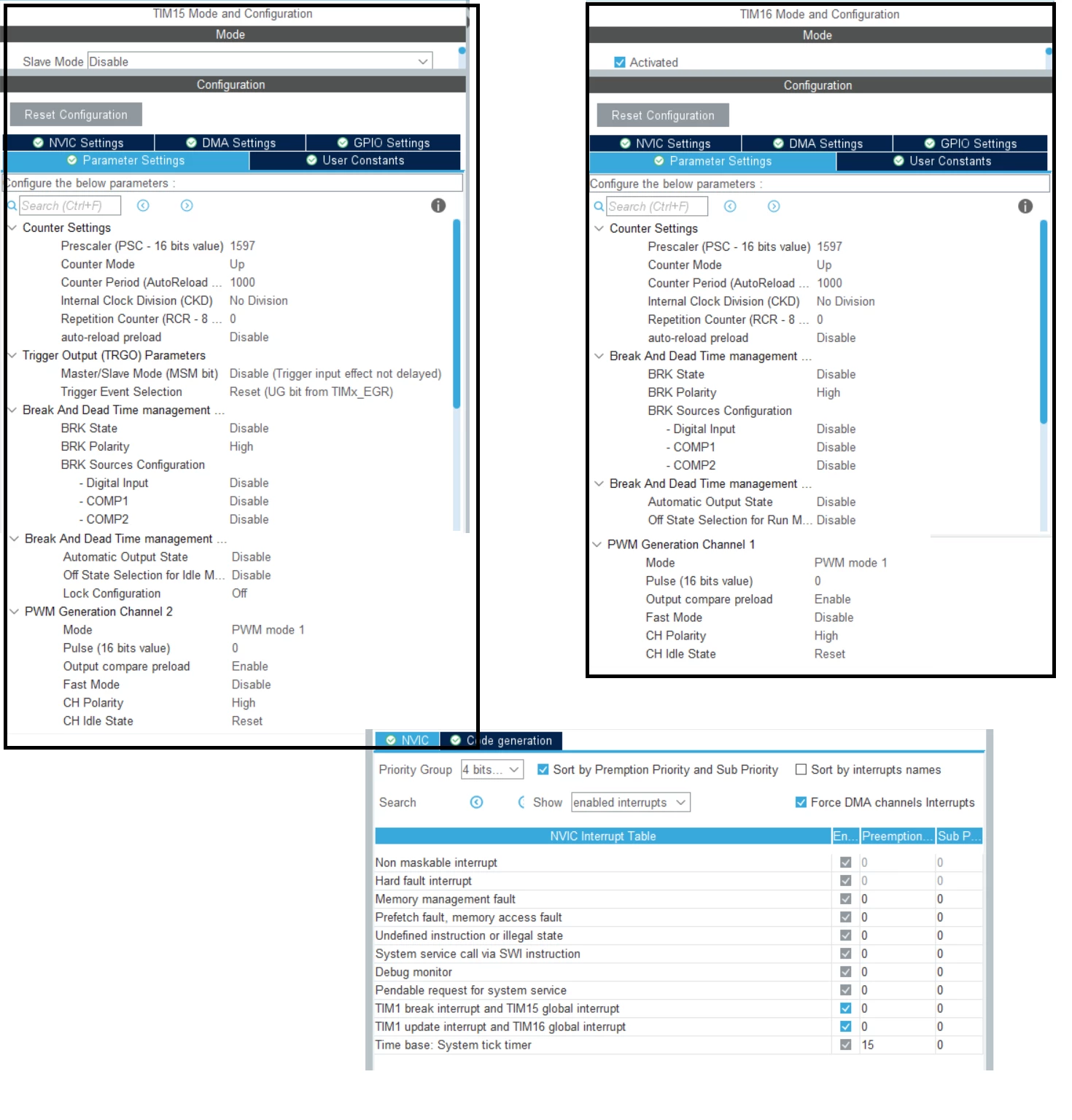

TIMx configurations:

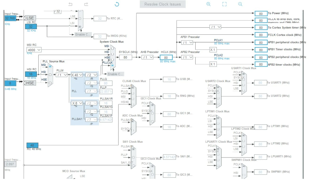

Clock configuration:

Your code doesn't output a TIM15 PWM signal until 13 seconds in. Are you waiting that long? Consider modifying TIM15 and TIM16 duty cycle at the same time.

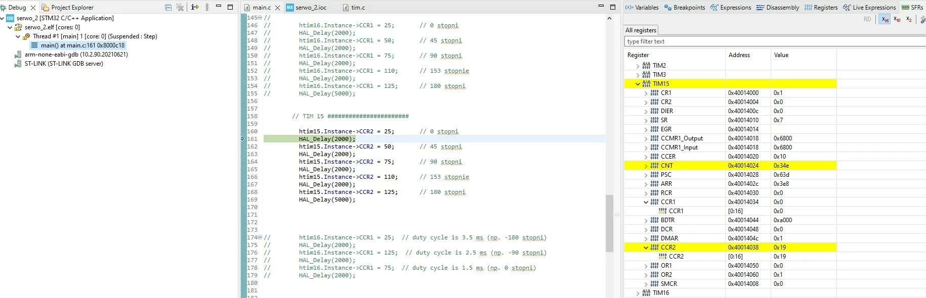

Debug code, verify that TIM15->CNT is changing and that TIM15->CCR2 is updating appropriately.
grzeniuxAuthor
CNT is changing

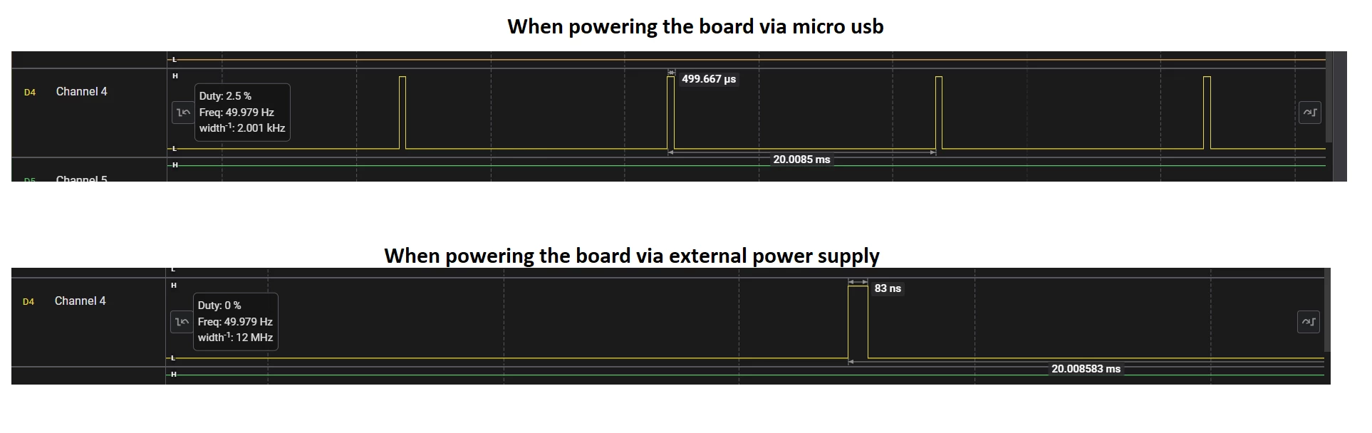

I discovered that when I power the device via external power then duty cycle = 0%, and when I disconnect it and leave the micro usb I have duty cycle = correct
I have no idea where I might have a short circuit or something
Seems like an issue in how the servo is connected then, or other hardware issue with it. PC3 is free on that board.

At 80 MHz to get the TIM at 50 KHz you'd need a prescaler of 1600-1 not 1597
Although having a broader ARR of 20000-1 would give a lot finer resolution
