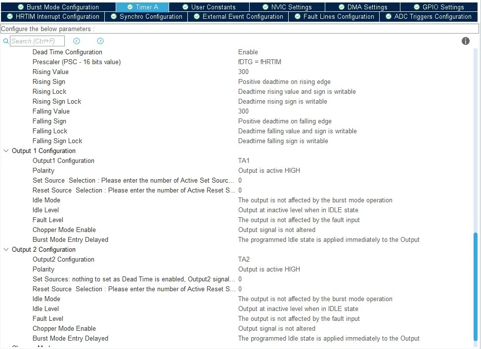

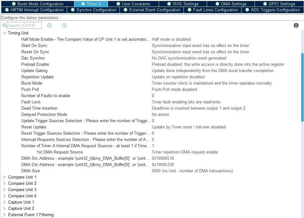

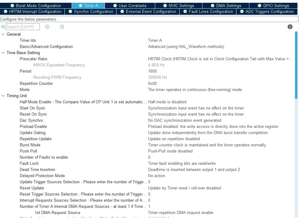

Hi, I am trying to generate a PWM signal using HRTIM and DMA in the STM32H745 Nucleo board. However, I am not getting any output. I have verified that the source and destination addresses for the DMA are correct. I think the issue may be with the configuration of the HRTIM or DMA.
I have attached the code and screenshots of configuration that I am using. I would appreciate any help that you can provide.

pTimeBaseCfg.Period = 1600;
pTimeBaseCfg.RepetitionCounter = 0x00;
pTimeBaseCfg.PrescalerRatio = HRTIM_PRESCALERRATIO_DIV1;
pTimeBaseCfg.Mode = HRTIM_MODE_CONTINUOUS;

pTimerCfg.DMARequests = HRTIM_TIM_DMA_REP;
pTimerCfg.DMASrcAddress = 0X10000518;
pTimerCfg.DMADstAddress = 0x10005338;
pTimerCfg.DMASize = 5000;
pTimerCfg.HalfModeEnable = HRTIM_HALFMODE_DISABLED;

pOutputCfg.Polarity = HRTIM_OUTPUTPOLARITY_HIGH;
pOutputCfg.SetSource = HRTIM_OUTPUTSET_NONE;
pOutputCfg.ResetSource = HRTIM_OUTPUTRESET_NONE;
pOutputCfg.IdleMode = HRTIM_OUTPUTIDLEMODE_NONE;
pOutputCfg.IdleLevel = HRTIM_OUTPUTIDLELEVEL_INACTIVE;
pOutputCfg.FaultLevel = HRTIM_OUTPUTFAULTLEVEL_NONE;
pOutputCfg.ChopperModeEnable = HRTIM_OUTPUTCHOPPERMODE_DISABLED;
pOutputCfg.BurstModeEntryDelayed = HRTIM_OUTPUTBURSTMODEENTRY_REGULAR;
if (HAL_HRTIM_WaveformOutputConfig(&hhrtim, HRTIM_TIMERINDEX_TIMER_A, HRTIM_OUTPUT_TA1, &pOutputCfg) != HAL_OK)
Error_Handler();
if (HAL_HRTIM_WaveformOutputConfig(&hhrtim, HRTIM_TIMERINDEX_TIMER_A, HRTIM_OUTPUT_TA2, &pOutputCfg) != HAL_OK)
Error_Handler();

    Hello @Pradeep Rajkumar, welcome to ST Community,
    Try configuring the SetSource and ResetSource, to determine which event will set or reset your output!
    You can set SetSource to HRTIM_OUTPUT_SET_TIMCMP1 and the ResetSource to HRTIM_OUTPUT_RESET_TIMCMP2 for example, which means, the output will be set when the counter reaches the compare register1, and resets when it reaches the compare register2
    July 15, 2023
    Thank you for your reply. Sure I will try your suggestion. In addition to this I think one more mistake is I need to use
    if(HAL_HRTIM_WaveformOutputStart(&hhrtim, HRTIM_OUTPUT_TA1)==HAL_OK){
    if(HAL_HRTIM_WaveformCountStart_DMA(&hhrtim, HRTIM_TIMERINDEX_TIMER_A) == HAL_OK){
    instead of HAL_HRTIM_SimplePWMStart_DMA() since have configured as Advanced (using HAL_Waveform methods) using function HAL_HRTIM_WaveformOutputConfig().
