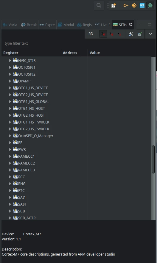

PSSI SFR not available while debugging (STM32H730)
Hey there. I am developing an application which uses the PSSI interface of the STM32H730. But while debugging the registers are not available in the SFR view. Any ideas?

Markus GIRDLAND
May 17, 2021 8:21 AM UTC
Hello there!
STM32CubeIDE only reads an .svd file to display these registers. I will submit a ticket to the responsible team for further analysis and possible correction.
If this is urgent then you can manually add it in the .svd file by default located at:
C:\ST\STM32CubeIDE_1.6.0\STM32CubeIDE\plugins\com.st.stm32cube.ide.mcu.productdb.debug_1.6.0.202102151443\resources\cmsis\STMicroelectronics_CMSIS_SVD\STM32H73x.svd
Thanks for bringing it to our attention!
EKoec
EKoecAuthor
May 17, 2021 8:29 AM UTC
Thanks for your quick reply. If i do a
grep -ri PSSI_CFG
in the respective folder it doesn't return anything so it seems to me the interface registers are missing from all svd files.
Markus GIRDLAND
May 17, 2021 9:33 AM UTC
You're correct. The information seems to be missing from the .svd files. I went ahead and created a ticket (internal BZ#107070). The team responsible for the updating of these files have been assigned to the ticket.
EKoec
EKoecAuthorBest answer
May 17, 2021 9:55 AM UTC
Adding..

 <fields>
 <field>
 <name>OVR_ISC</name>
 <description>Data buffer overrun/underrun interrupt status clear</description>
 <bitOffset>1</bitOffset>
 <bitWidth>1</bitWidth>
 </field>
 </fields>
 </register>
 <register>
 <name>PSSI_DR</name>
 <displayName>PSSI_DR</displayName>
 <description>PSSI data register</description>
 <addressOffset>0x28</addressOffset>
 <size>0x20</size>
 <access>read-write</access>
 <resetValue>0X00000000</resetValue>
 <fields>
 <field>
 <name>BYTE3</name>
 <description>Data byte 3</description>
 <bitOffset>24</bitOffset>
 <bitWidth>8</bitWidth>
 </field>
 <field>
 <name>BYTE2</name>
 <bitOffset>16</bitOffset>
 </field>
 <field>
 <name>BYTE1</name>
 <bitOffset>8</bitOffset>
 </field>
 <field>
 <name>BYTE0</name>
 <bitOffset>0</bitOffset>
 </field>
 </fields>
 </register>
 </registers>
 </peripheral>
... to
STM32CubeIDE/plugins/com.st.stm32cube.ide.mcu.productdb.debug_1.xxxxx/resources/cmsis/STMicroelectronics_CMSIS_SVD/STM32H73x.svd
seems to do the trick, no guarantee for correctness, though.
Markus GIRDLAND
Jun 11, 2021 9:58 AM UTC
As a quick update:
This has been corrected and will be part of the next release of STM32CubeIDE.
