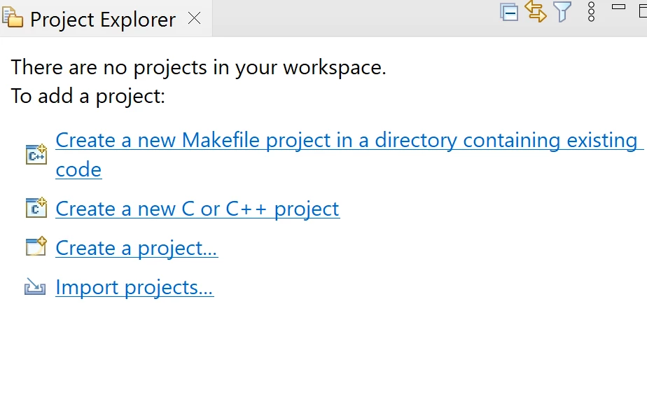

Projects not importing CubeIDE 2.0
I open up CubeIDE, select a workspace, click “Import projects”  the project explorer tab (excuse the typo)
There is project there,
But nothing appears in the Project Explorer,

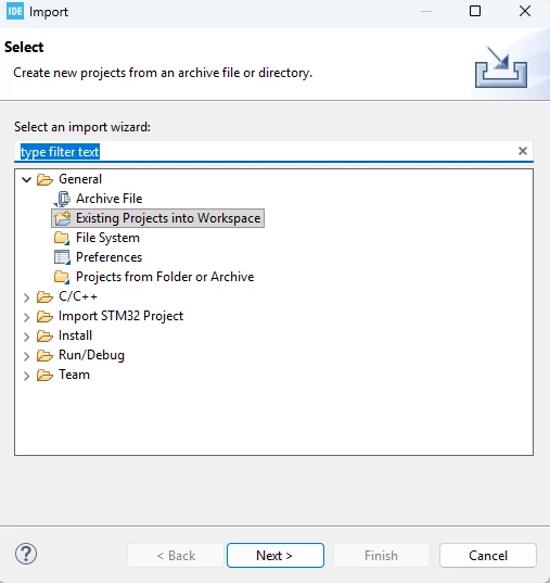

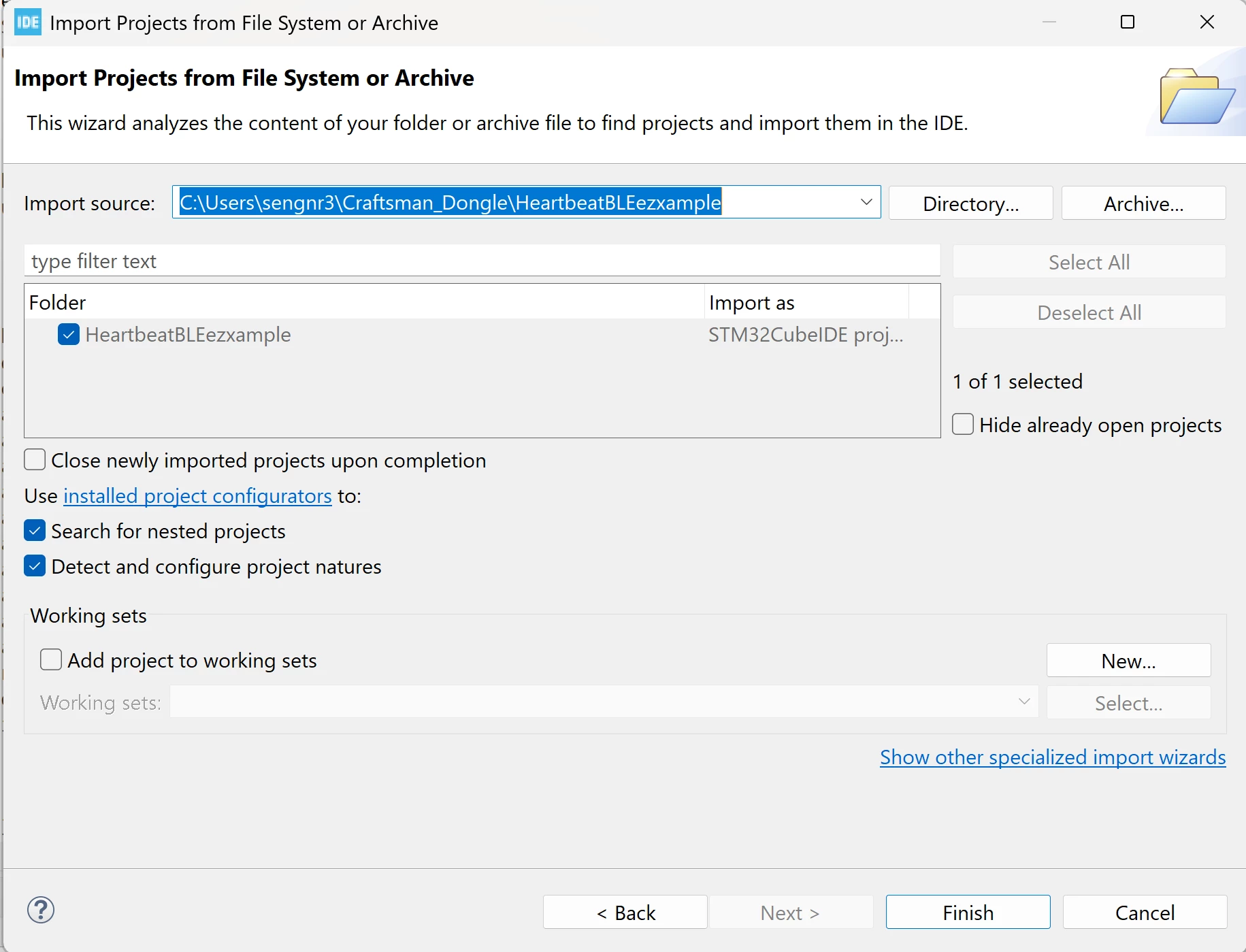

Import as an existing project. Select the root folder of the project.

Trips me up every time, thanks
