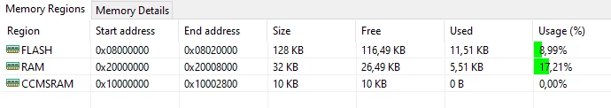

The ST example has an extra CCMSRAM section, but I don't think this can be my issue here:
0693W00000DqWNwQAN.pngThe EEPROM emulation in my project has starting address 0x08010000U

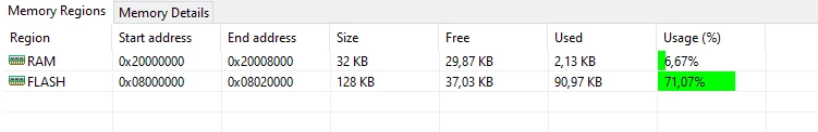

0693W00000DqWOuQAN.pngI'm a bit surprised by the 71% here, it's a small simpel code project.
Do I have to configure the EEPROM emulator as starting address after 0x08020000?
Or is CCMSRAM section really necessary?

Seems like your code occupies part of the same flash being used for EEPROM emulation.
A reset will start with running your own code, provided BOOT0 is down, or similar. If that's not happening, perhaps it's because the EEPROM emulation erased part of it. Examining memory with STM32CubeProgrammer would confirm.

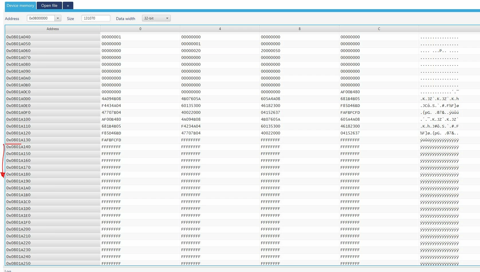

When I compile and program my project with the EEPROM package included, my Flash starts to free up space at 0x0801A140
So before my EEPROM start address was 0x08010000 and clearly overlapping.
Now I changed it to 0x0801A190 but the main code isn't running anymore.
For EEPROM emulation I need 2 pages of 2kbytes, 256 words of 64 bits
Aug 27, 2021 7:34 PM UTC
The EEPROM flash page must be located in a page not used by your code. It can't start midway through a page.
