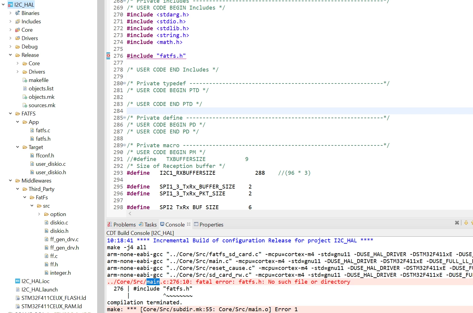

project structure changes when switching from debug to release mode
I have a compilation error when I switch from debug mode to release mode, as showed in the pic below:
What did I miss?

Check the Include Paths settings for the "Release" build vs prior "Debug" ones that worked and found the include file.

Below are the compiling commands:
  • Debug compiling command:
    arm-none-eabi-gcc "../Core/Src/main.c" -mcpu=cortex-m4 -std=gnu11 -g3 -DDEBUG -DUSE_HAL_DRIVER -DSTM32F411xE -DUSE_FULL_LL_DRIVER -c -I../Core/Inc -I../Drivers/STM32F4xx_HAL_Driver/Inc -I../Drivers/STM32F4xx_HAL_Driver/Inc/Legacy -I../Drivers/CMSIS/Device/ST/STM32F4xx/Include -I../Drivers/CMSIS/Include -I"D:/ST/workspace_CoTSHM/I2C_HAL/FATFS/App" -I"D:/ST/workspace_CoTSHM/I2C_HAL/FATFS/Target" -I"D:/ST/workspace_CoTSHM/I2C_HAL/Middlewares/Third_Party/FatFs/src" -O0 -ffunction-sections -fdata-sections -Wall -fstack-usage -MMD -MP -MF"Core/Src/main.d" -MT"Core/Src/main.o" --specs=nano.specs -mfloat-abi=hard -mthumb -o "Core/Src/main.o"
  • Release compiling command:
    arm-none-eabi-gcc "../Core/Src/main.c" -mcpu=cortex-m4 -std=gnu11 -DUSE_HAL_DRIVER -DSTM32F411xE -DUSE_FULL_LL_DRIVER -c -I../Core/Inc -I../Drivers/STM32F4xx_HAL_Driver/Inc -I../Drivers/STM32F4xx_HAL_Driver/Inc/Legacy -I../Drivers/CMSIS/Device/ST/STM32F4xx/Include -I../Drivers/CMSIS/Include -Os -ffunction-sections -fdata-sections -Wall -fstack-usage -MMD -MP -MF"Core/Src/main.d" -MT"Core/Src/main.o" --specs=nano.specs -mfpu=fpv4-sp-d16 -mfloat-abi=hard -mthumb -o "Core/Src/main.o"
In the release case, two folders were omitted strangely by the IDE.

I thought IDE would take care of that. :thinking_face:
I just did and the compilation error is gone; but got error of undefined reference to a few functions. I guess there is still some diff in setting details.

Depends, the IDE treats the two contexts differently, so if you, or whomever created the project, add paths to one they won't automatically appear in the other.
The Release built typically enables optimization, removes assert and other verbose debug information. How much it improves things depends on the code, but it should shrink the size, and increase the speed in measurable amounts. Review the .MAP file output, and perhaps benchmark your critical code.
