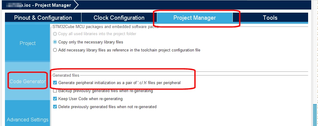

You can configure CubeMX to generate separate .c/.h files:

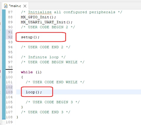

If you're familiar with the Arduino setup() and loop() structure for your user code, that can easily be achieved in the Cube-generated structure as:
That way, you can leave all the generated code alone - much as you never see Arduino's main() - and just work in your own files with your setup() and loop() functions ...

Thank you Andrew, that really helps. Especially the Code Generator bit. I will still have to duplicate some boiler plate code between projects, but at least there will be specific places where to put the wrappers. This should be the default IMHO.
I wasn't after replicating anything arduino-like and the setup / while(1) structure is already in the STM main.c, so that was good enough for me, as those are are only calling a single function each in my case. Also I wasn't after using ArduinoIDE to manage the STM projects (and miss out on debugging).

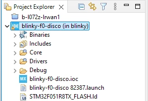

The standard project structure that CubeIDE generates is:
  • Binaries contains the generated project binary - usually a .elf file
  • Includes is auto-generated
  • Core contains your project-specific generated source - including the main() function in main.c
  • Drivers contains the standard HAL drivers
  • Debug contains various intermediate build output
I would create a separate folder for my user code - at the same level as Core.
But you can structure your projects entirely as you wish.
For example:
In this case, my user code is in the 'common' folder
(I called it "common" because it is common to several projects: details here, if you're interested)
