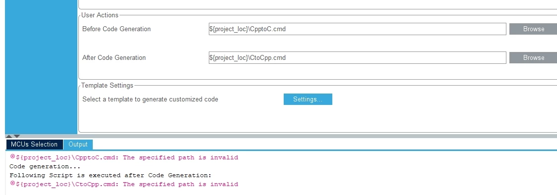

${project_loc} in DCT will not work
I have written 2 cmd files. The first renames the main.cpp to main.c before the code generation runs. and the second renames main.c back to main.cpp afterwards. The files are in the project path. The plan was to access them with ${project_loc}\CppToC.cmd.
But this does not work.
Is there a solution?

    STM32CubeMX isn't going to support Eclipse variable expansion. Use an absolute path, or figure out where it wants those files and use a relative path.

    i don't want an absolute path, becouse if you  copy the  Project or open it on an other PC the path will not fit.
    i tried to take the file only, but this is not working. Can we tell/beg STM to support the Eclipse vars in the DCT?
    Padawan
    So use a relative path, perhaps just the file name. It's probably looking in the same directory as the IOC file.
    CubeMX is a standalone product. Probably isn't a good way to support eclipse variable integration.

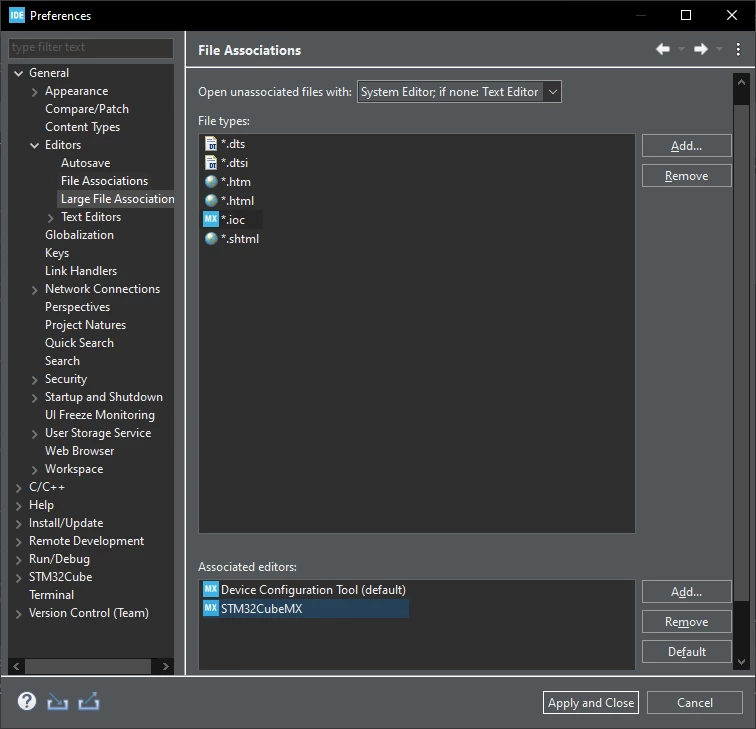

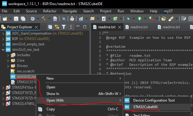

    mattias norlander
    Hi Pavel,
    I guess we could do that... Trouble is normally to provide such feature across all OS we want to support.
    As an alternative to that approach the use can manually do this play with the file associations instead to force ioc-files to be opened with MX stand-alone:
    Word of caution: If you set the "STM32CubeMX" editor as "Default" the project wizard will break :(
    Internal ticket reference: 139637
    My recommendation would be to just add this "editor" but not set it as Default. Means double-click on ioc-file will still open it inside the IDE. But, use this flow to open the ioc-file with MX stand-alone. A little bit less convenient than a double-click. But the project wizard remains functional.
    I don't know if that is useful or not? In theory, you can now use whichever external MX tool you want to configure and generate the project. Keep in mind that this is not a validated use case. But I still think it can be helpful in many cases.
