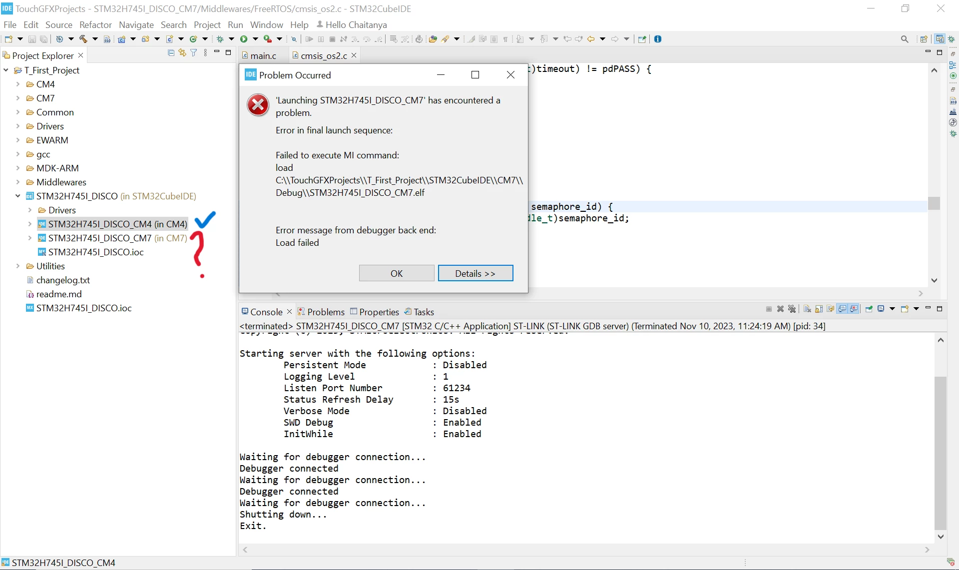

Project imported from TouchGFX but not able to debug for board STM32H745I - DISCO
@Osman SOYKURT
Board : STM32H745I - DISCO
Cubeide : v.1.13.2
TouchGFX : v4.22.1 Designer
i did generate code in touchgfx then imported the entire project in cube IDE.
STM32H745I - DISCO as it is dual core m4 and m7
1st i did build and debugging for STM32H745I_DISCO_CM4 <--- (check in image). It is successful.
2nly done with building for STM32H745I_DISCO_CM7 <--- (check in image) .It is successful
But while debugging the STM32H745I_DISCO_CM7 ;
i am facing following issue ??????
Error in final launch sequence:
Failed to execute MI command:
load C:\\TouchGFXProjects\\T_First_Project\\STM32CubeIDE\\CM7\\Debug\\STM32H745I_DISCO_CM7.elf
Error message from debugger back end:
Load failed
Load failed
Load failed
Load failed

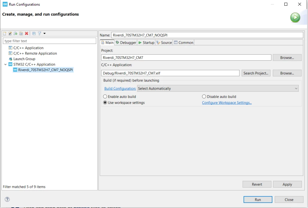

Hello, considering what you mentioned above, I think that it has to do with your run configurations. Could you please share with us what run configurations you have? How do you connect the screen with the PC? In the run configuration format you have to find the proper .elf file for your screen and define it in the main option. I have posted a picture, which is showing what run configurations I have for another screen (Riverdi).

I followed above video and changed the run setting of project
Senior
November 10, 2023
So I suppose that I helped you to search something in order to find the solution. Could you please accept my reply as an answer?

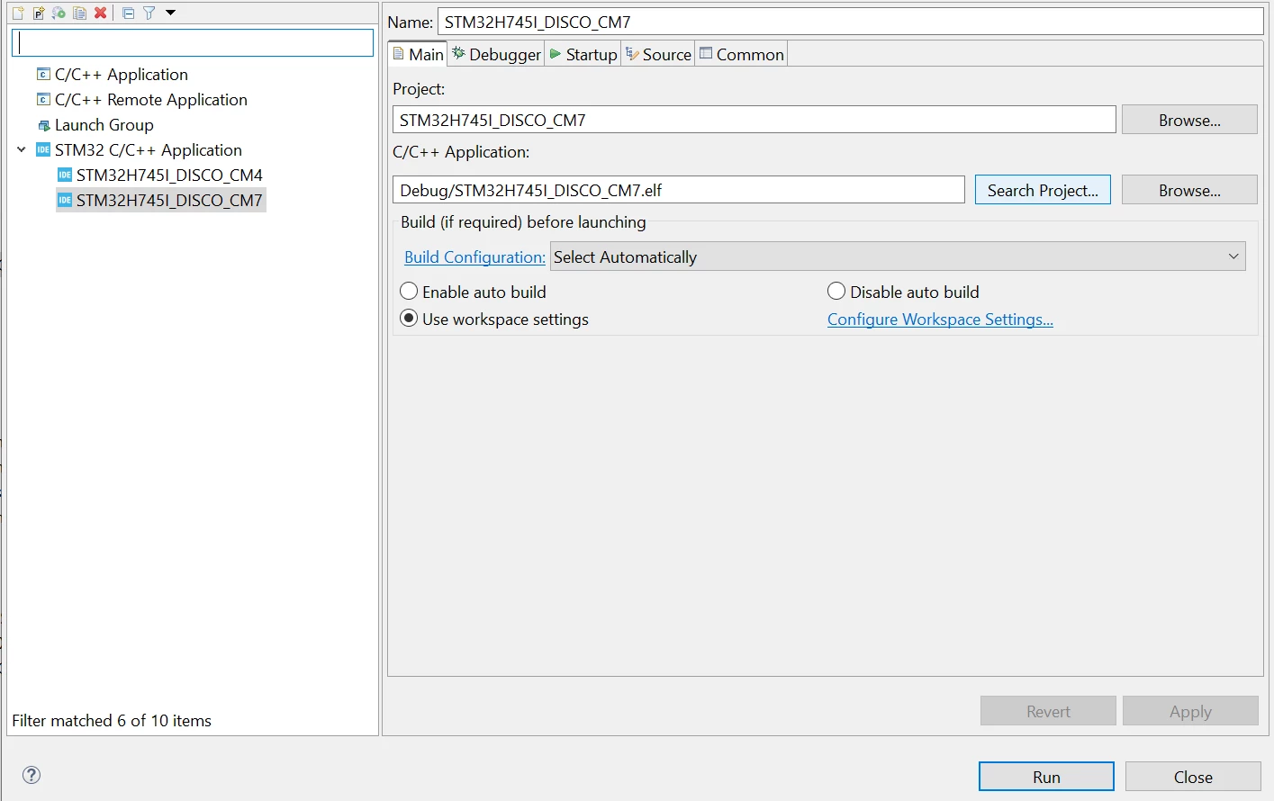

Hello @Chaitanya1997 ,
I recommend you follow this application note AN5361 in "3 Debugging" section, that covers the configurations needed to debug STM32H7 Series Dual-core in STM32CubeIDE.
Imen
November 10, 2023
YES
i followed the same steps given in manual then also facing the same issue for debugging.
Could please check the same at your end ??
