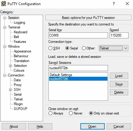

2. When I try to access the Port status with the CLI (PuTTY) it shows me the following output everytime I Press the B2 Button:
I use the following Settings:
Baudrate: 115200
Data bit: 8
Parity: none
Stop bit: 1
Hardware Flow Control: None

About CLI, there no 'CLI out' like demo code embedded into fresh board, that's why you cannot get trace.
You can use https://www.st.com/en/development-tools/stm32cubemonucpd.html#get-software to get message traces.
