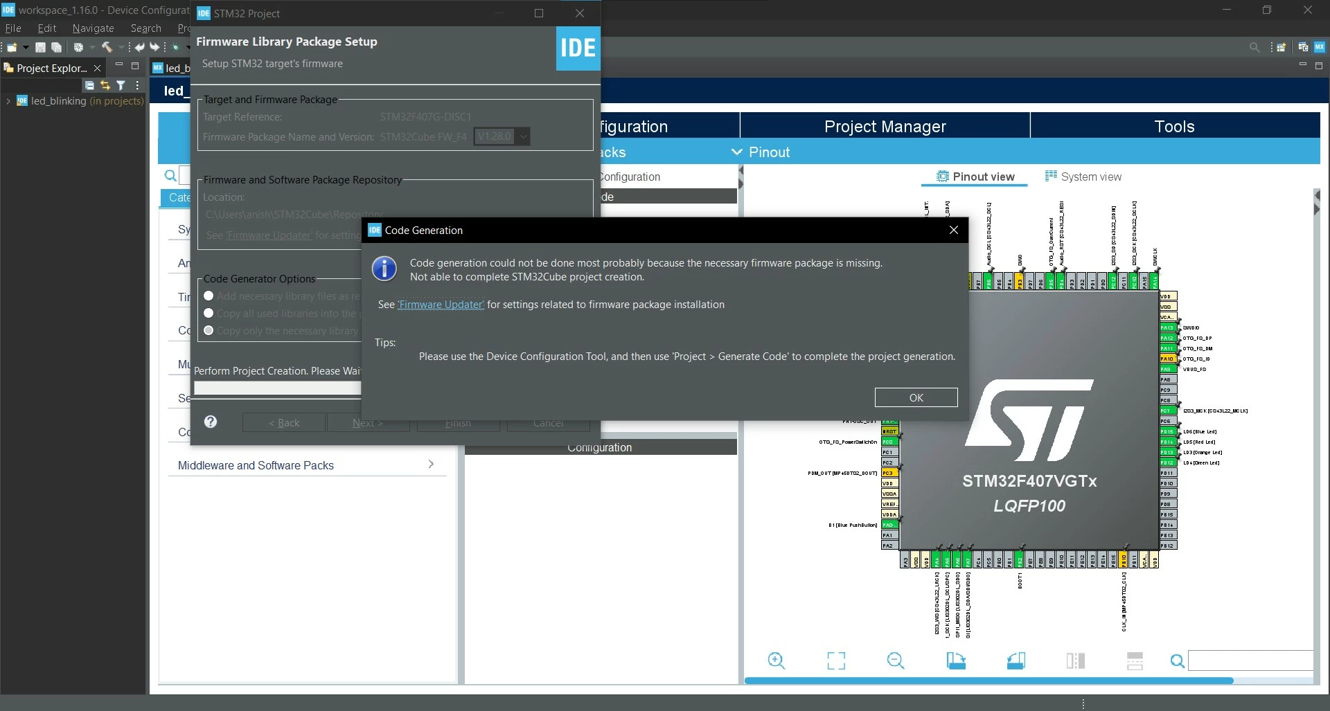

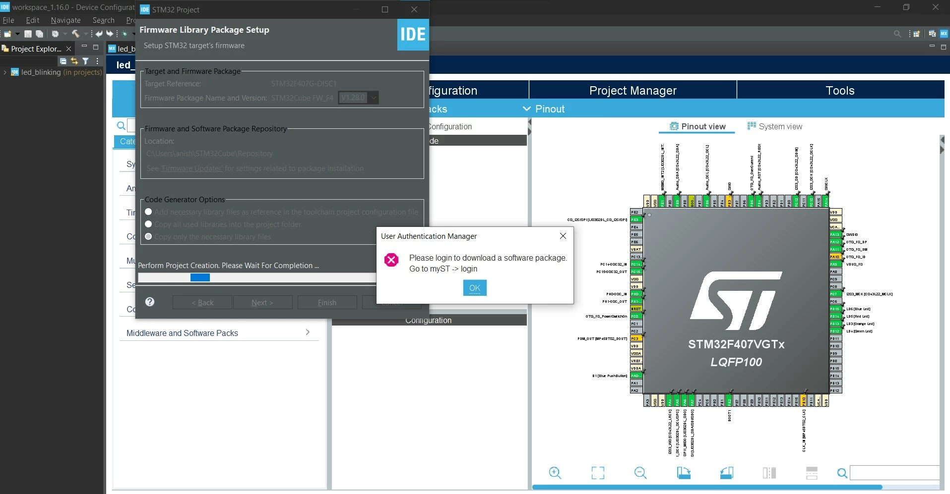

I installed STM32CubeIDE and have been trying to create a project using the STM32F407G-Discovery Board.
Upon trying to create a project, the startup code generation file doesn't show up.
I get the following pop-ups. I am unable to resolve this issue.
What am I supposed to do here?What am I supposed to do here?What do I need to downloadWhat do I need to download

    So did you login and download the firmware package?

    which firmware package should I download and how?

    Hello @anishac and welcome to the community,
    To solve this problem, check the connection under Window->Preferences->Firmware updater, then login to myST. The firmware for F4 will be successfully downloaded.
    Thanks,
    Rim.

    Hi @Rim LANDOLSI ,
    I did download the F4 package and added it to the repository folder, and tried creating a project and the same issue came up again. Unable to figure out why though.
