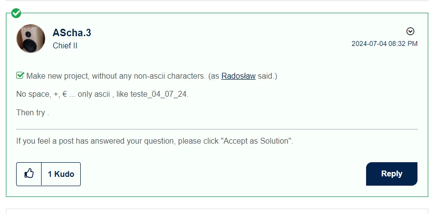

    Andrew Neil
    July 4, 2024
    It's not showing ...
    It should get a tick and green background - like this:
