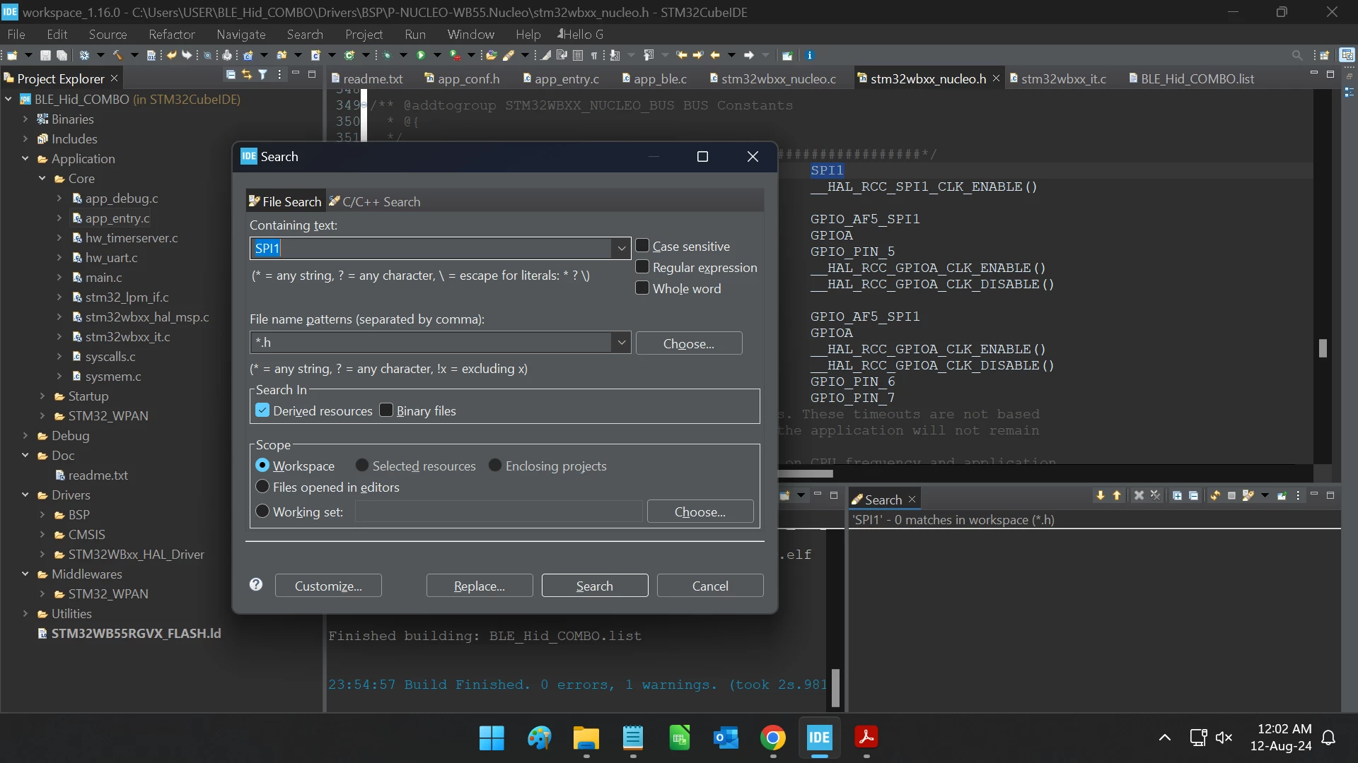

1+2) Does the project build? If not, probably the file you want isn't indexed as it doesn't think the project is valid.
3) Search for text should work. Ensure you're searching the entire workspace or wherever the file is, and that the file type is valid. Show screenshot if you're having trouble. Search -> File... has a lot of options.

3. Search does not find anything even in *.h files - see "SPI1" on right side of Search window:
SearchSearch

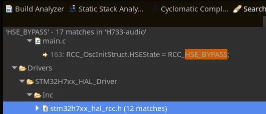

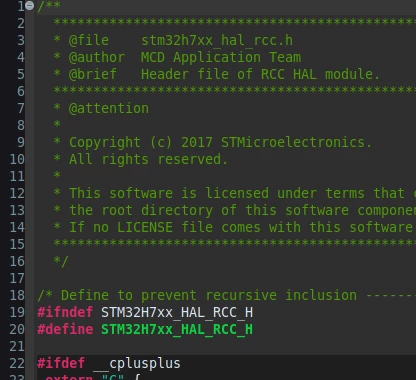

AScha.3
August 30, 2024
just mark the text you wanna search -> right click mouse -> (in popup menu) search text -> project ...then you see:
click on the file/line and the file is opened and you are at the position you want to see: (in .h or .c files)
