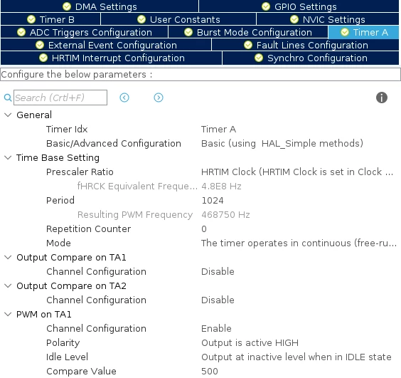

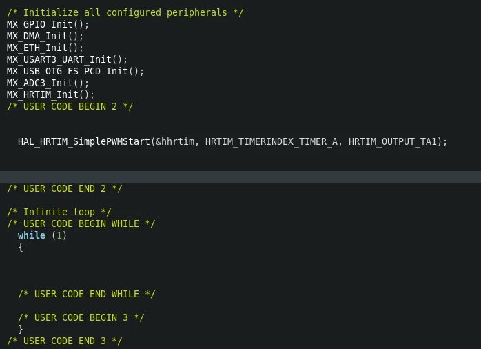

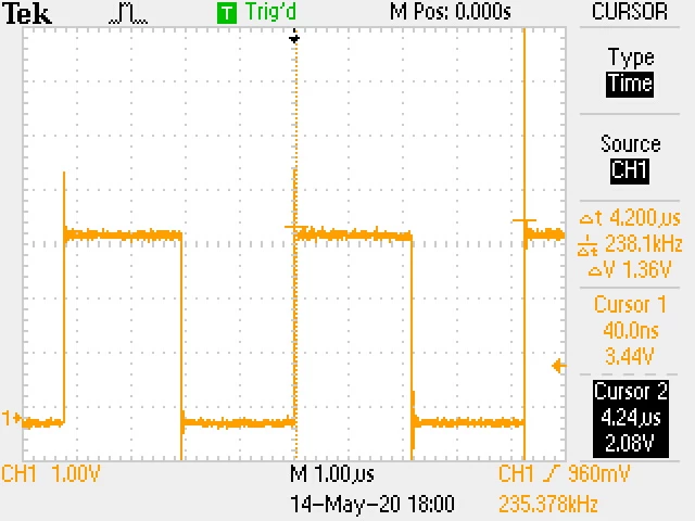

Hello Everybody
I have the Problem with my Hightimer PWM Output.
If I define that my HRTIM is working with 480MHz (CPU_Ck).
it will not and work with the normal 240MHz Output.
Why is that so?

Are you trying to get a PWM signal at 240MHz? That's above the max frequency of the GPIO pins.

I try to get a faster 10 Bit PWM signal, because of that i need the high resolution timer with 480MHz instead of 240MHz.
