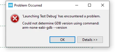

Problem with debugging programs on STM32CubeIDE: Error: "Could not determine GDB version"
After an update i am not able to debug my program. I have already tried an new installation of the STMCubeIDE 1.12.0 but it still doesn't work. I've already tried to add a local toolchain in the Toolchain Manager, but the error still apears. Does anybody have an idea to solve this problem? :)

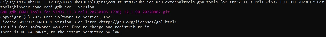

    Hello @Stone1234
    I suggests you to start by locating the GDB Server
    1. Ensure that it exists at the customer file system. Example: C:\ST\STM32CubeIDE_1.12.0\STM32CubeIDE\plugins\com.st.stm32cube.ide.mcu.externaltools.gnu-tools-for-stm32.10.3-2021.10.win32_1.0.200.202301161003\tools\bin
    2. Open “cmd” in the folder containing gdb and try to execute arm-none-eabi-gdb.exe --version
    It is possible that anti-virus software has either deleted gdb or prevented it from launching. Test 1&2 should be sufficient to tell you if this is true…
    I will wait for  your feedback.
    KR,
    Semer.
    Stone1234Author
    June 23, 2023
    Hello CHERNI,
    thank you for the quick reply.
    I executed the steps 1 & 2 and got this as the result from cmd:
