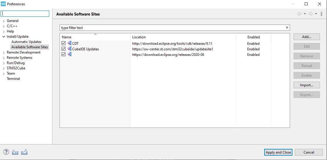

I have two machines with Cube IDE installed. On one there is version 1.6.1 and the other is 1.7.0
I want to update both to be able to open .ioc files from a college that has the 1.8.x
The proxy settings are setup rigth because i am able to get the newest embedded software packages updates.

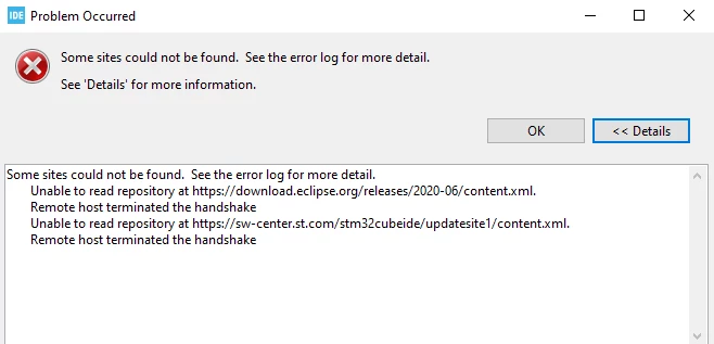

But if i try to check for updates of cubeIDE i get following errors on both machines:
0693W00000JPTaxQAH.pngThis are my settings for repositories:
0693W00000JPTYhQAP.pngHope some one can help me to figure out my mistake.

Best answer by Piranha
Just in case... You can always download and update it manually.
https://www.st.com/en/development-tools/stm32cubeide.html
Tesla DeLorean
Guru
February 11, 2022
Some kind of AV or firewall?
Need to use a proxy server?

Thank you, i did it manually.
