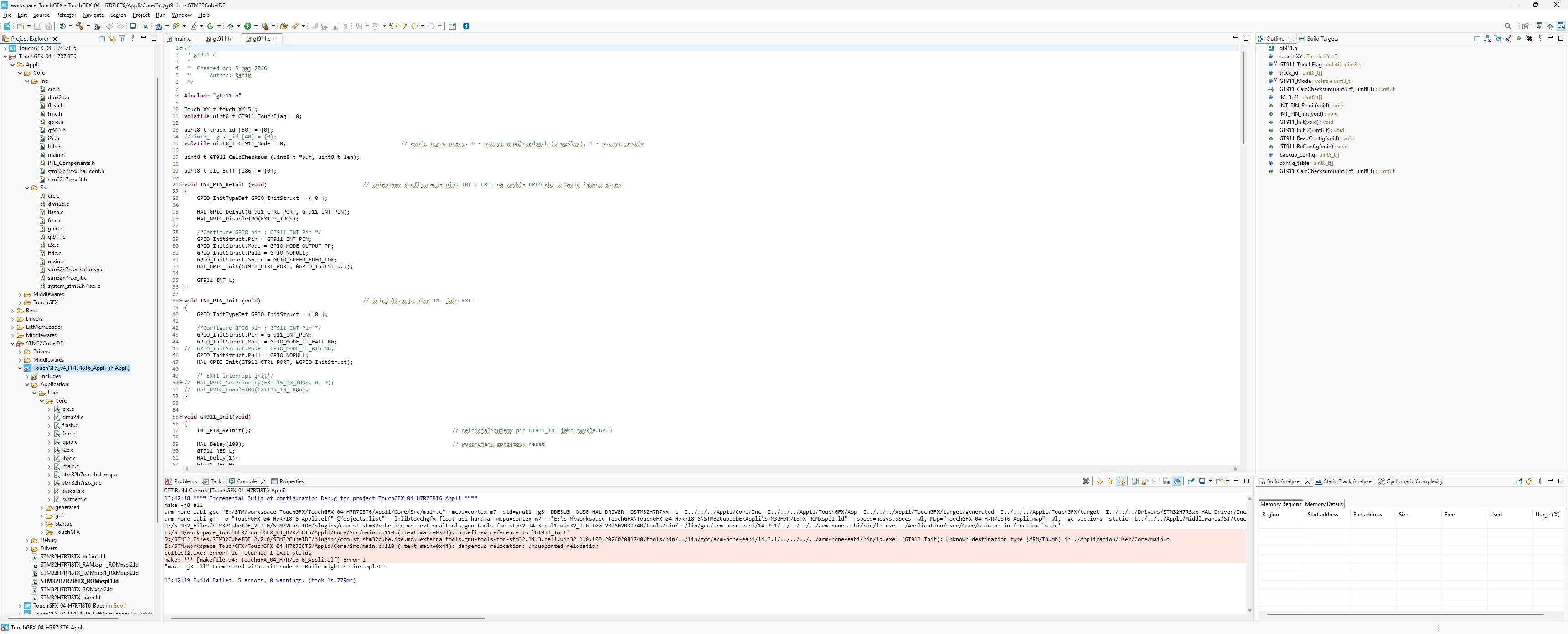

I'm creating a TouchGFX project for a custom PCB with an STM32H7R7I8T6. After initial compilation issues, I unchecked the "Generate Under Root" option in the project manager and managed to compile the empty project and upload it to the MCU. Now I want to add a driver for the GT911 touch panel. I add one file, gt911.h, to the "Appli/Core/Inc" location, and it's visible, but the gt911.c file in the "Appli/Core/Src" location isn't visible to the project. This is my first time using this project organization and I can't figure it out.

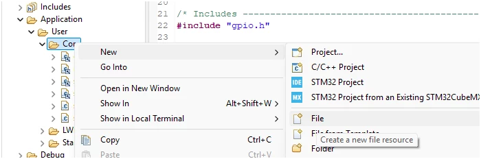

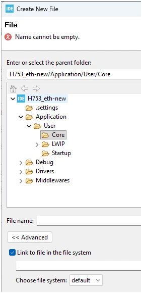

This actually adds a “linked” source file to Eclipse project.
In the GUI: select New… File
Then : Advanced -> Link to file in the file system, and enter the actual .c file path.
It can differ from the “link” filename, just as usual with symlinks.

I managed to solve the problem somewhat through the backdoor.
I edited the ".project" file and manually added the following entry:
</link>
    <name>Application/User/Core/gt911.c</name>
    <type>1</type>
    <locationURI>PARENT-2 PROJECT_LOC/Appli/Core/Src/gt911.c</locationURI>
</link>

Aug 17, 2026 5:21 AM UTC
I tested your method and it works. Thanks. This is the first time I've used this file system (with the "Generate Under Roots" option unchecked). Previously, I simply dragged the file to the appropriate folder...then the program asked how to import the file, and that was enough. I've never had any compilation problems. Most ST tutorials used this method...
