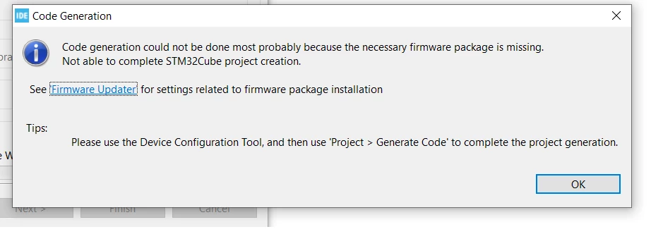

Problem when trying to generate code on stm32cudeIDE with f103c8
I bought Blue pill (stm32103c8) and downloaded the stm32IDE.
Once I try to open project, after I choose the board I get a message that there is a problem
and the reason is probably I don't have the necessary firmware.

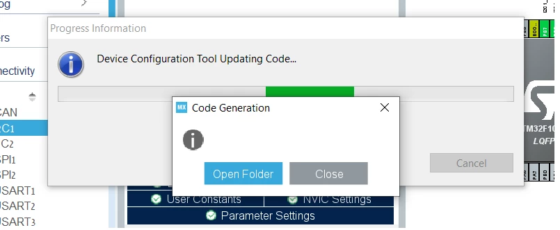

After I try to generate code I see this.
 I can't complete my project opening.
What can I do?
TDKBest answer
May 23, 2021 2:29 PM UTC
Go to Help -> Manage Embedded Software Packages and download the missing software package.
