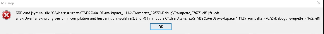

Hello, I'm working with STM32CubeIDE, a Nucleo-F767ZI board and STM STUDIO for debugging.
Suddenly STM STUDIO doesn't work and displays the attached message.
I'm stuck. I've reinstalled everything but it gives the same result. Everything worked fine a few months ago.

Have you updated CubeIDE recently? Which CubeIDE version have you reinstalled?
Explorer II
Hello, I am experiencing the same issue. I installed CubeIDE version 1.13.2 and STM STUDIO applications this week.
Pavel A.
The root cause looks like new toolchain installed with newer CubeIDE produces ELF debug info with version number unknown to STM Studio. Workaround: use older toolchain.
