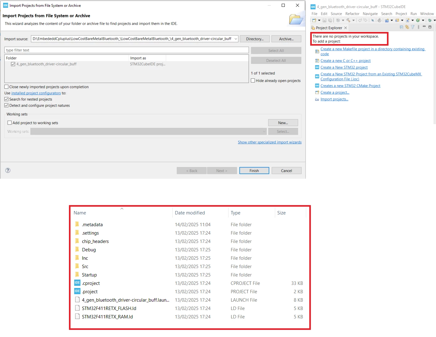

Problem opening a project CubeIDE
Win 10, x64, STM32CubeIDE version 1.17.0
I'm trying to open a CubeIDE project from a workspace but it just doesn't load, see image below.
I select the folder for my workspace, click finish & am then told that there are no projects in the folder. Yet the folder does contain a CubeIDE project. The open project option is also greyed out in the projects menu pull down.
What am I missing here?

Turns out I was not in the workspace directory from where the project was created, which was further up the directory hierachy.
