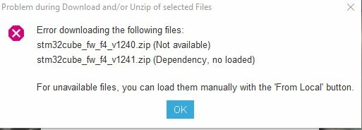

problem during download and/or unzip of selected files
  • May 5, 2019
  • 1 reply
  • 3471 views
I got this error several time. (for stm32f4 discovery board). is there any solution? if no, how can i load manually this file? where can i download? due to this error, I haven't used ide yet.0690X000008BHDWQA4.jpg

Usually you could pull from the CubeF4 download page, get CubeMX to pull them into the repository, or use the mirrored versions I've posted on occasion.
https://drive.google.com/open?id=13_gTp_j6BYiE-jfH4p6ZqjYI_rot2_bA
https://drive.google.com/open?id=1w3VPPLhSvGpkCKa_9ypu7nLLB_bqKTa7
Make sure you have enough hard drive space to hold the download itself, and the unpacked version, figure 2x the ZIP size.
