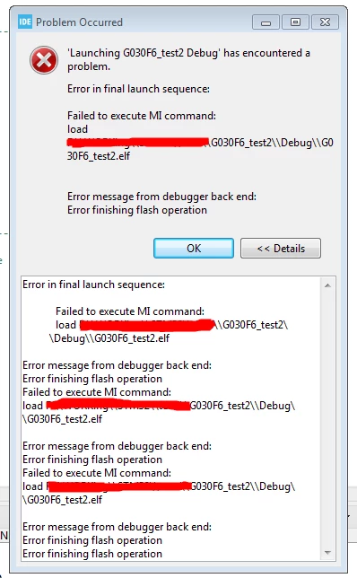

Hello.
After updating STM32CubeIDE to 1.15.0 I faced this problem :(
I can't run or debug any projects. Of course, software for STLink was updated.
Hope, someone has a solution.
My console includes this information:
Encountered Error when opening ..........\com.st.stm32cube.ide.mcu.externaltools.cubeprogrammer.win32_2.1.200.202311302303\tools\bin\STM32_Programmer_CLI.exe
Main alert
Error in final launch sequence:
Failed to execute MI command:
load ...........\\G030F6_test2\\Debug\\G030F6_test2.elf
Error message from debugger back end:
Error finishing flash operation

    Thank you. I had reinstaled my OS and new CubeIDE started to work.

    Hello @DmitriG ,
    According to the attachment it seems that you are using an older Windows version, but CubeIDE is only supported for Windows 10 and 11. This might affect the IDE functionality.
    Regards,
    Rim.
