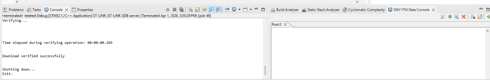

I am trying to print data but nothing seems to be working , I do not have cables to use COM, but I am sending data using SWV ITM, anyone who might know what's wrong , thanks!.

KING2Author
Apr 1, 2026 10:27 PM UTC
When I upload the code it works as excepted on the SMT32F407-DISC1 board, but timestamps can not show in the SWV interface

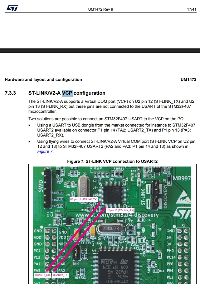

@KING2 wrote:
works as expected on the SMT32F407-DISC1 board
So compare & contrast your non-working setup with the DISC1 board
Apr 6, 2026 9:47 AM UTC
Hello @KING2, and welcome to ST Community!
To enable timestamps during debugging, click on the wrench icon in the debug toolbar and check the option Enable Timestamps.
Best regards,
To improve visibility of answered topics, please click 'Accept as Solution' on the reply that resolved your issue or answered your question.
Andrew Neil
Apr 7, 2026 9:53 AM UTC
@KING2 wrote:
SMT32F407-DISC1
The User Manual tells you how to add the VCP (Virtual COM Port)  connection:
https://www.st.com/resource/en/user_manual/um1472-discovery-kit-with-stm32f407vg-mcu-stmicroelectronics.pdf#page=18
via: https://www.st.com/en/evaluation-tools/stm32f4discovery.html#documentation
Alternatively, just add an external USB-to-UART adaptor
