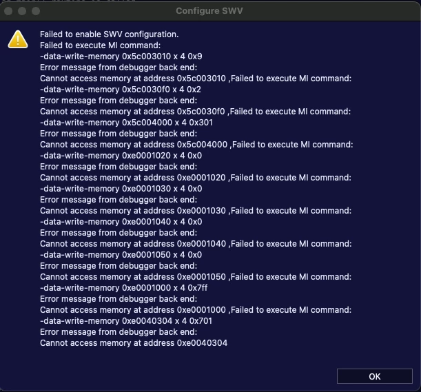

Hello everyone,
I program on stm32h757 with stm32cube IDE on macOS Sonoma. (stlink v3 minie)
Until recently, I debugged with the st link and displayed printf in the swv console without any problem.
For technical reasons, I made the program work with the st link and the J trace. Since then, printf only works with the J Trace.
When I use the st link, I get an error message at start-up (see attached image)
Can anyone help me?

    Hello, thank you for your answer.
    I still have the problem, same error message and the st link stops responding(Target is not responding, retrying... Shutting down... Target is not responding, retrying...)
    I tried with another st link and same thing.
    Is it possible that I have a problem with initialisation?

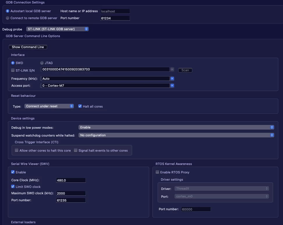

    I modified my debug configuration by checking "limit to clock" and setting 2000 kHz to max and now I get the error:
    SWO trace already running on another core.
    Any Idea ?

    after few try error comme back ...
