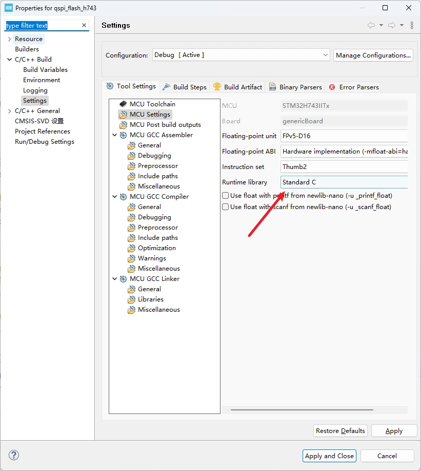

Hi guys,
I'm executing the "printf" in CubeIDE to output uint64_t with "%llu", but the printout is wrong.
Why does it not support "%llu"?
However it can work well in Keil.
//debug.c
int __io_putchar(int ch) //Redirect printf to uart
 HAL_UART_Transmit(&huart1, (uint8_t *)&ch, 1, 0xFFFF);
 return (ch);
//main.c
int main()
printf("%llu\r\n", (uint64_t)1 ); //Hope to output "1", but output "lu"

    This is because the C runtime library in the GNU toolchain supplied with CubeIDE has limited implementation of printf. It does not support %ll and some other formats. Keil MDK provides their own runtime library, high quality and thread aware. This is one of reasons why Keil MDK is worth its price ))

    Thanks for answering, I found that CubeIDE uses the "reduced C", and the problem can be solved by modifying to "standard C" .

    just a simple test : what its doing with :  "%lu" ?
    printf("%lu\r\n", (uint64_t)1 );
    PeterMuAuthor
    I used a ftp server lib which actually used "%llu",this makes my project cannot work. because it returns wrong message from ftp server.
