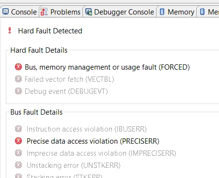

Whenever the compiler executes
printf("frequency %f: %f \n", ((float32_t)(i * SAMPLING_RATE) / FFT_BUFFER_SIZE), output_fft_mag);
it goes to HardFault.
I attach main.c and syscall.c
All the code that we need to analyze is inside the function void get_sineval_FFT2()
Here's the problem:
EDIT: The problem is only there when I try to printf floats ... whereas with normal strings or ints everything goes

    Look at what's actually faulting. The MCU instructions and registers.
    Do regular printf() or putchar() work, or do they fault too?
    Keil, but the mechanics are the same..  https://github.com/cturvey/RandomNinjaChef/blob/main/KeilHardFault.c

    With breakpoints, the compiler is faulting exatcly when printf is executed, it doesn't matter what its argument is ... I tried as well to write printf("Hello \n"); and HardFault occours.
    Does that answer your comment? Because it is not very clear to me when you say "verify using instructions and registers" and what should I do with the code in the link you sent me

    I mean at the MCU level not at the C function level. Something with finer granularity, and not the broad side of a barn..

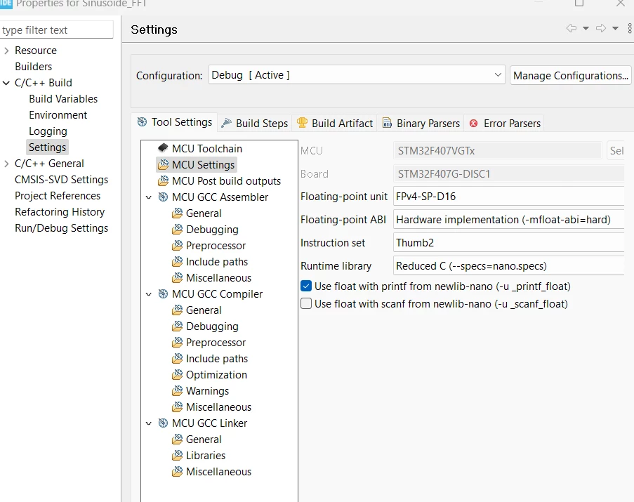

    Do you enable the FPU in your SystemInit() code?
    Has it linked the appropriate C library. 32-bit ARM code will fault a CM4F processor.
    The call to printf() or the code within the function?
    Does the CubeIDE provide some sort of Hard Fault Analyzer function or window?

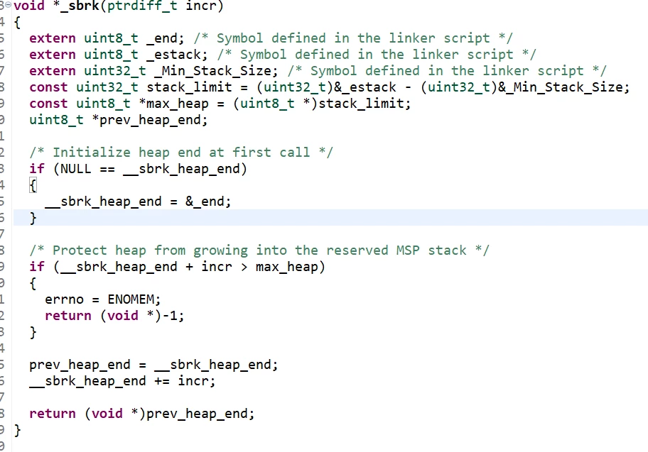

    The last thing on the call stack is malloc_r (malloc) so check the pool (size, address....). Where _sbrk() is implemented? Do you have sysmem.c ?
    luke514Author
    November 2, 2023
    _sbrk() is in sysmem.c

    >The problem appears only when I try to printf floats
    Printing floats in the newlib requires something more than integers - maybe, extra allocation. So, not surprising. You can look for alternative 3rd party printf that is more eco-friendly. This or others.

    I finally solved it by declaring "double" variables to be used inside print .. and not "floats". However, the code doesn't print what it is supposed to print, and I hope it is not due to this little change
    Pavel A.
    November 3, 2023
    This is very strange. Floats passed to printf  must be automatically converted to doubles. Something else goes on there. The float 'coprocessor' not enabled by startup?
