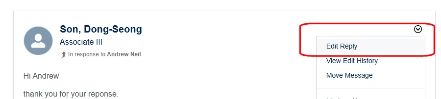

Please see How to insert source code - the indentation is all lost now, so you'll need to copy again from your original.
You can edit the post:

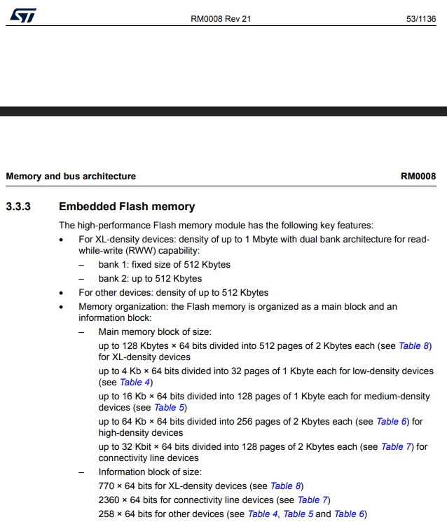

I don't see in that code where you set the location of your emulated EEPROM within the Flash ?
Also, how much of the Flash is used by your code?
