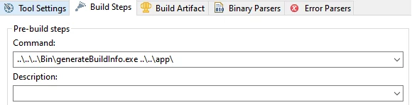

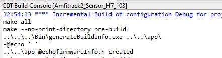

HI.
Im calling a exe file from CubeIde
0693W000007EW75QAG.pngit worked fine in true studio but now I get this -@echo in my file name.
 0693W000007EW7AQAW.pngcan anyone tell me what Im doing wrong and how to avoid it

[Edited] Perharps the backslash? Try /

thanks, problem solved..
