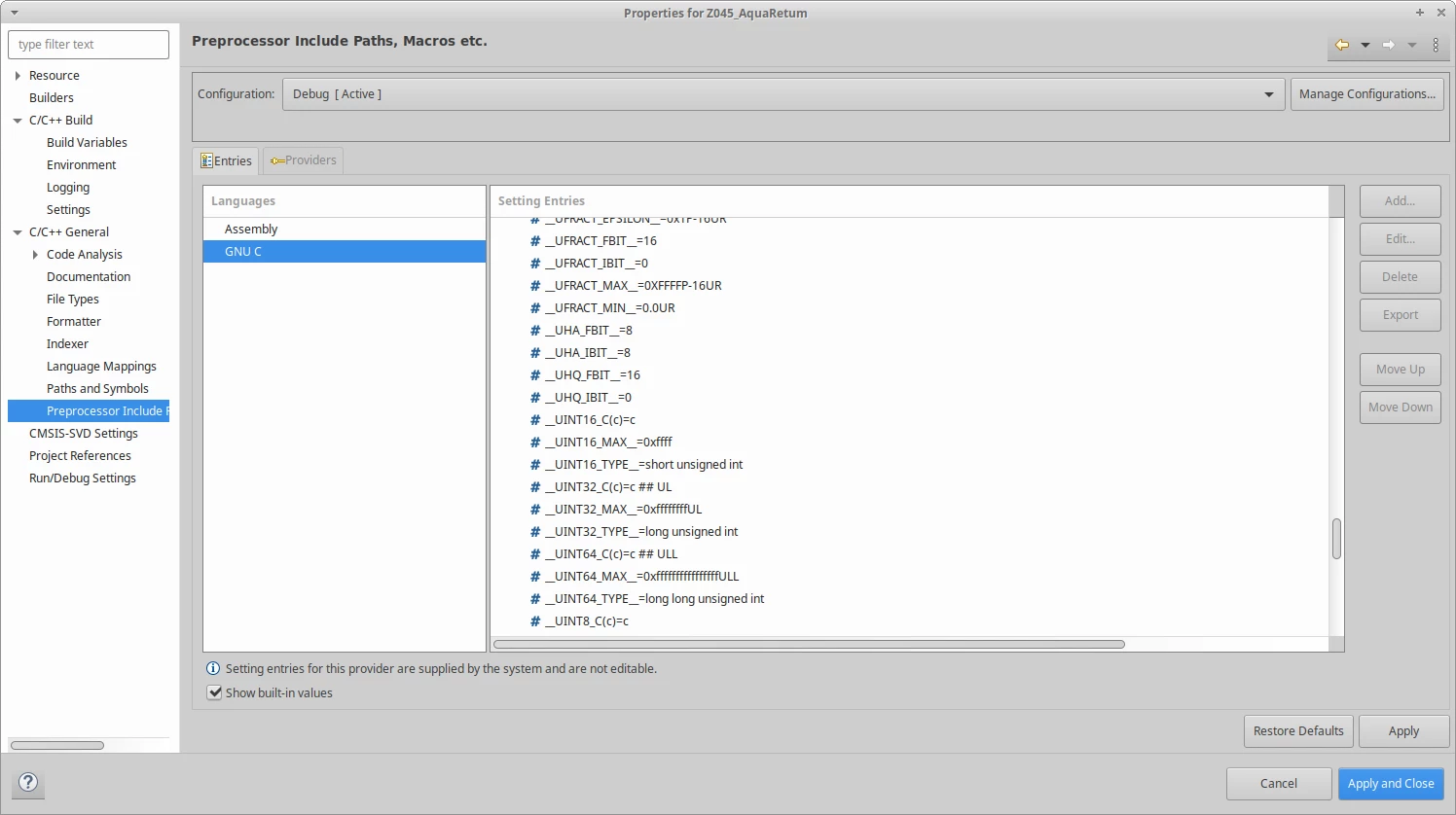

 Edit:
In CodeIDE, or more correctly, Eclips... I found the propertie page named "Preprocessor include paths, Macroes etc., and for GNU C there was a list of settings entries .
I am a bit unsure if these only affects the Eclipse settup or the project build itself.
Atleast there where a quite long list of definitions
Anuone know if these settings are used during a build? Cause I do not have these as part of my ported project...
