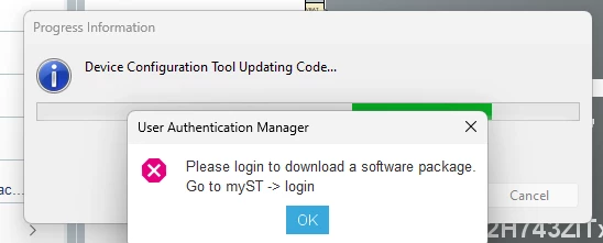

Please login to download a software package
I cannot update my .ioc !
Why has this message suddenly appeared?
What software package????
I've been using Cubeide for years.
I have tried logging in etc. etc. as per all the forum posts.
I get an OK when I use 'check connection'
What is happening to ST?

    There is an option to login to STM32 IDE, on the top navigation bar right next to Window, Help, you should see a tab named MySt. Click on that, you will see an option to login, once you do so try to save again and see if that automatically downloads needed software package and generates the code.

    They've added this "improvement" in recent times. Suggest you make sure you can log in and download Cube repositories. That whatever browser or proxy settings are required to download one of the updates.
    Jan 7, 2024 9:21 PM UTC
    Within STM32CubeIDE, press Alt+L to login or select it from the menu bar.
    Jan 8, 2024 6:25 AM UTC
    Don't worry, it is not a bug, it is just a feature to improve the user experience !
    Are you trying to migrate your old project after an upgrade of STM32CubeIDE ?

    Thanks All!
    I've just realised that the user code defines are a bit screwed. Repairing these solved the problems.
