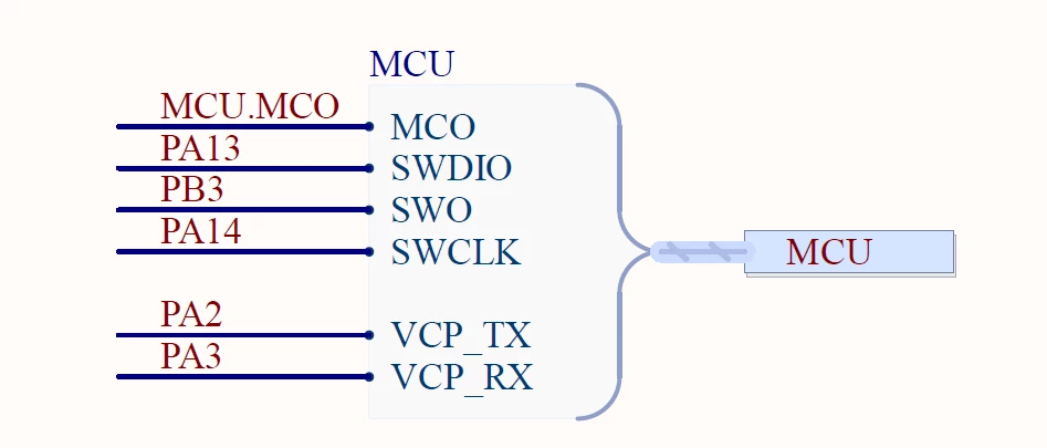

I'm using the  board NUCLEO-C071RB, and now i want project my board.
I have a question about the pin PB3:

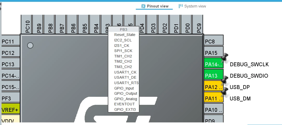

From the schematic it seems PB3 = SWO but if i try to configure the pin with STM32CubeIde i don't find that option.

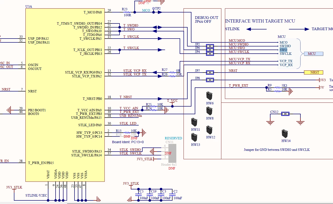

@AndrewFFFF wrote:
I'm using the  board NUCLEO-C071RB ...From the schematic it seems PB3 = SWO but if i try to configure the pin with STM32CubeIde i don't find that option.
The STM32C071RB  doesn't have SWO.
Presumably, the schematic is a general one for any Nucleo-64 board - covering the case where the Target STM32 does have SWO.
