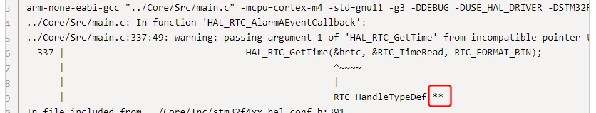

passing arguement 1 of 'HAL_RTC_GetTime' from incompatible pointer type
I am getting the below warning when I compile my application. However, HAL_RTC_GetTime API expects the first argument of type pointer to a RTC_HandleTypeDef structure, thats what I provide, but I get this warning as highlighted below.
15:34:16 **** Incremental Build of configuration Debug for project RTC ****
make -j8 all
arm-none-eabi-gcc "../Core/Src/main.c" -mcpu=cortex-m4 -std=gnu11 -g3 -DDEBUG -DUSE_HAL_DRIVER -DSTM32F407xx -c -I../Core/Inc -I../Drivers/STM32F4xx_HAL_Driver/Inc -I../Drivers/STM32F4xx_HAL_Driver/Inc/Legacy -I../Drivers/CMSIS/Device/ST/STM32F4xx/Include -I../Drivers/CMSIS/Include -O0 -ffunction-sections -fdata-sections -Wall -fstack-usage -fcyclomatic-complexity -MMD -MP -MF"Core/Src/main.d" -MT"Core/Src/main.o" --specs=nano.specs -mfpu=fpv4-sp-d16 -mfloat-abi=hard -mthumb -o "Core/Src/main.o"
../Core/Src/main.c: In function 'HAL_RTC_AlarmAEventCallback':
../Core/Src/main.c:337:49: warning: passing argument 1 of 'HAL_RTC_GetTime' from incompatible pointer type [-Wincompatible-pointer-types]
 337 | HAL_RTC_GetTime(&hrtc, &RTC_TimeRead, RTC_FORMAT_BIN);
 | RTC_HandleTypeDef **

void HAL_RTC_AlarmAEventCallback(RTC_HandleTypeDef *hrtc)
	printf("Alarm is triggered\n\r");
	HAL_GPIO_TogglePin(GPIOD, GPIO_PIN_14);
	RTC_TimeTypeDef RTC_TimeRead;
	RTC_DateTypeDef RTC_DateRead;
				HAL_RTC_GetDate(&hrtc, &RTC_DateRead,RTC_FORMAT_BIN);

It seems a conflict between the first input argument of the callback and the definition of the global rtc handle declared in the top of your main.c:
RTC_HandleTypeDef hrtc;
So remove & before hrtc from here:
Does it resolve your issue?
5 replies
mƎALLEm
mƎALLEmBest answer
April 5, 2024
LCE
Principal III
April 5, 2024
input handle hrtc is already a pointer, so only remove the "&" for hrtc.
HAL_RTC_GetTime(hrtc, &RTC_TimeRead, RTC_FORMAT_BIN);
That is why I don't like HAL, as hrtc might be a handle, or a pointer to a handle.
In my C sources, pointers always start with "p", like phRtc, or pu32Var.
It really helps to avoid these problems.
Andrew Neil
April 5, 2024
Note that the compiler was telling you that you were providing a pointer-to-pointer (double indirection):
