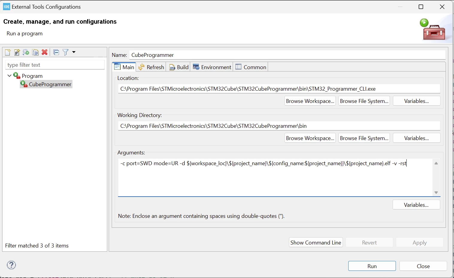

    Hi @Andrew Neil
    I don't think there is a nice GUI window as in Keil, I'm using the external tool configuration and depending on the argument you specify it can do either mass erase or only needed sectors:
    For the sectors needed only, the argument is:
    -c port=SWD mode=UR -d ${workspace_loc}\${project_name}\${config_name:${project_name}}\${project_name}.elf -v -rst
    For mass erase instead:
    -c port=SWD mode=UR -e all -d ${workspace_loc}\${project_name}\${config_name:${project_name}}\${project_name}.elf -v -rst
    You can even skip the flash erase, or only some sectors. Everything is explained in the STM32_Programmer_CLI help.
    Have a nice day,
    Kraal

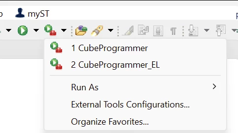

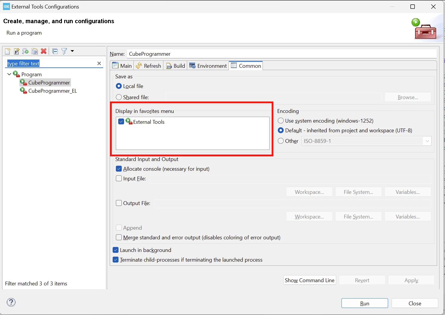

    Jun 7, 2024 11:43 AM UTC
    From the external tool configuration, the last tab "Common" there is a checkbox under "Display in favorites menu" that you should check (red box below) :
    Your configurations will then show in the main menu in the IDE :
    Note that you don't need to develop the drop down menu if you always use the same configuration, you can directly click on "Play_toolbox" icon (if you hover over it, the text shall say "use latest tool" or something like so).
    Warning: in my case, I have to select the project I want to flash in the project pane for the tool to work OK. Otherwise it fails to convert ${workspace_loc}\${project_name}\${config_name:${project_name}}\${project_name}.elf into something meaningful and will comply.
