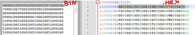

I compare the .bin file and .hex, data is the same.

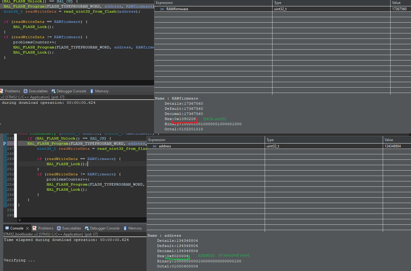

I debug my program i I correct write data to flash  (exmaple in screen).
But its not working maybe I do something wrong.
Maybe i should write data as little endian?
My first data line is:
:10 0000 00 00000320010902086D08020873080208 B5
Its ok when I write for example: (look screen of debug)
0x08020000: data: 0x00000320
0x08020004: data 0x01090208
etc.

November 28, 2023
Data in memory needs to be in the same order as in the file. The system is little endian so data should appear reversed when interpreting it as a uint32_t.

I want to understand correctly.
If I have first line:
Data is: 00000320 01090208 6D080208 73080208
Should I write like this?
0x08020000, data: 0x00000320
0x08020004, data: 0x01090208
0x08020008, data: 0x6D080208
0x0802000C, data: 0x73080208

November 28, 2023
If "data" is a uint32_t, it should be reversed compared to what is shown in the hex file.
0x08020000, data: 0x20030000
Isn't this easily verified? Try one way, if it's reversed in memory, then reverse it before writing.

November 29, 2023
You are the best TDK :)
I wasn't sure, I had more problems, but your answer helped me - you have right.
Data in .hex file is Big Endian, and we have to change it to Little Endian.
