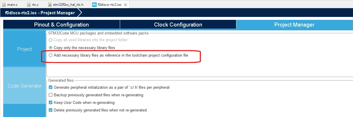

An advantage of copying is that your project is self-contained.
It can also mean that you can't get hit by unexpected updates breaking things!
But CubeMX/CubeIDE does give you the option to link rather than copy:

What you want is not supported in the current CubeMX framework. You can add links to folders if you want, and put files there, but there is no "package manager" like feature that will automatically link and download the version of the library you want.
The "Embedded Software Packages" get downloaded into a main repository folder and from there are copied to your project folder on code generation. If you want to do this manually, you can link to the repository folder instead, but this would be a manual step.

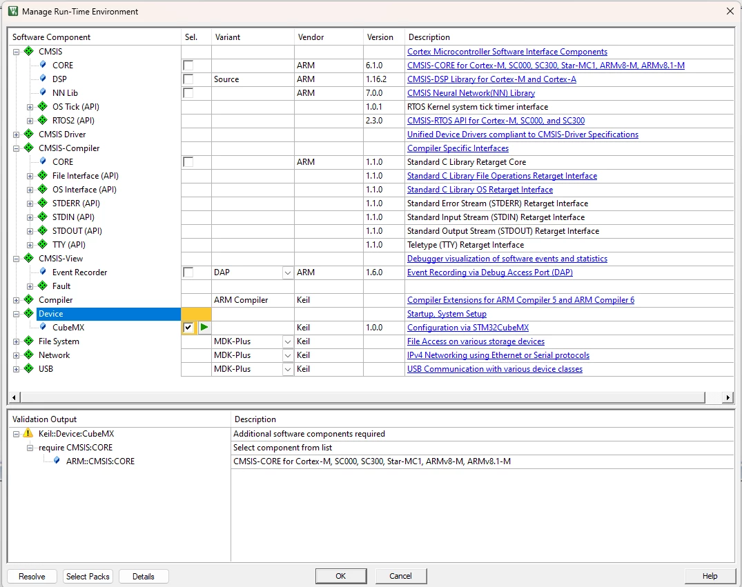

And that exactly is the key argument for a package manager. If the HAL v21.4.2 depends on CMSIS v1.0.0, then a package manager must exactly solve this, download the appropriate packages, and link them/add them to the project/solution.

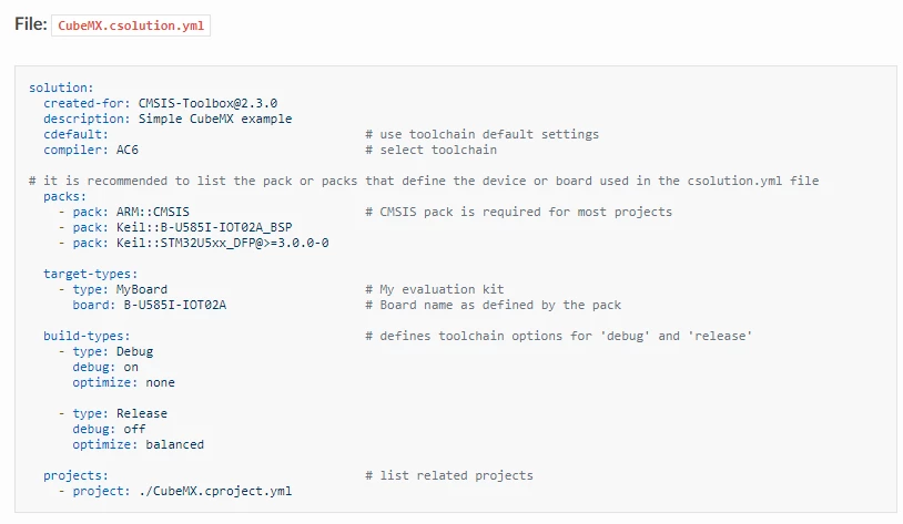

E.g., if I choose a STM32U5xxx and CubeMX support in Keil's package manager, it tells me that CMSIS-Core is required:
I was hoping for something similar in ST's solution.
Looks like I will go and use the CMSIS-Toolbox way, see CMSIS-Toolbox and Configure STM32 Devices with STM32CubeMX - CMSIS-Toolbox. Which is open-source and (silicon-) vendor independent BTW.

Maybe we are talking at cross purposes. You don't need to copy the libraries into your project and you don't need to download the libraries for every project. If you start a project for an MCU you never used before, CubeIDE downloads all libraries for this MCU, put in into a local "repository" and you have to link (not copy) all the files you need, referenced to the library folder. You can add the library folder to the search path list and simple include the files. When starting a new project for the same MCU family, all libraries are already there.
The backup of a project only contains the user code, not the libraries, but the references to the library folders. After restoring the backup you have to check if the libraries are present in the right version.
