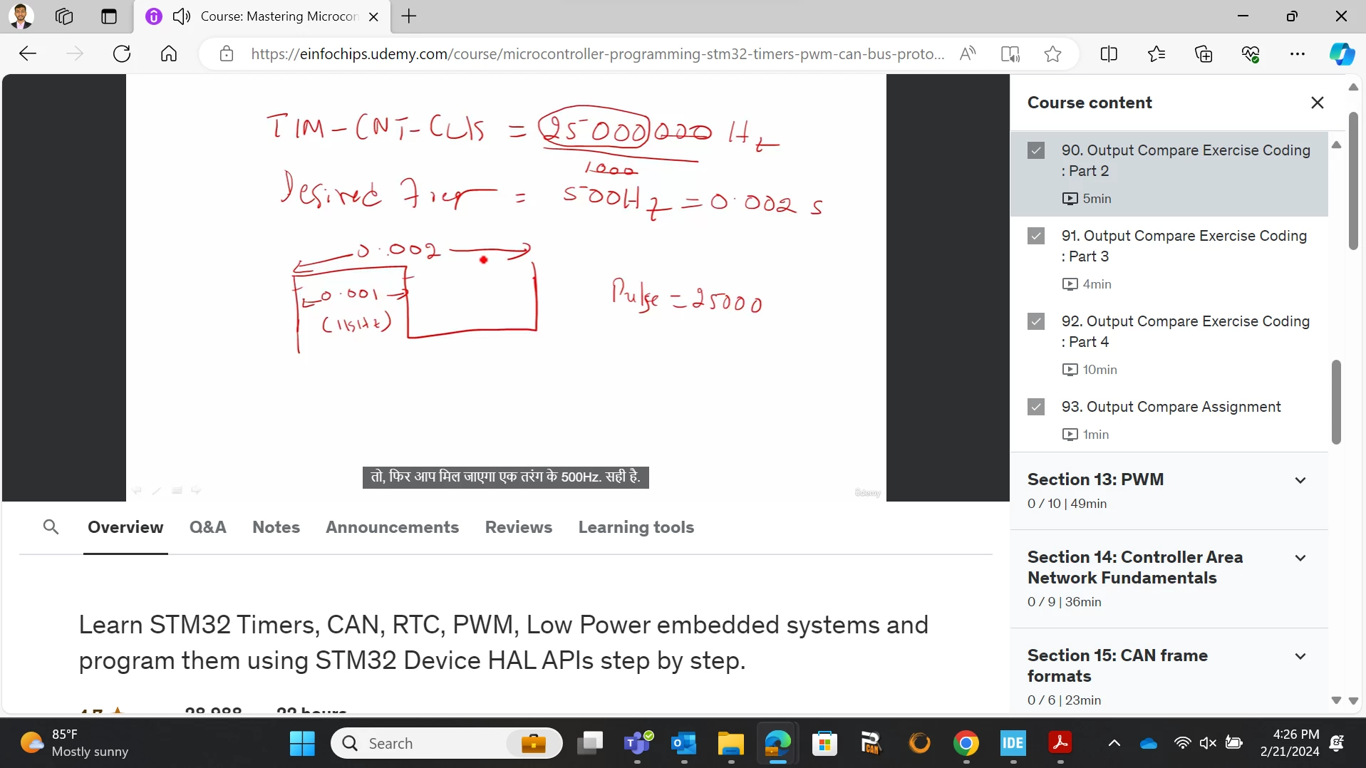

    MG1Author
    February 21, 2024
    Here mentioned that:
    TIM_CNT_CLK = 25Mhz and desired frequency is 500Hz.
    So, on period time is 0.001 second and off period is 0.001 for 1Khz frequency.
    Pulse value is 25000.
    So, it will generate 1Khz frequency.
    By change this value can I get other frequency?
    waclawek.jan
    February 21, 2024
    No, that's 500Hz, as you've said yourself in previous sentence.
    That determines the ON period. But by changing "pulse value", the OFF period also changes, so that the sum of the two remains the same (and so the frequency remains the same).
