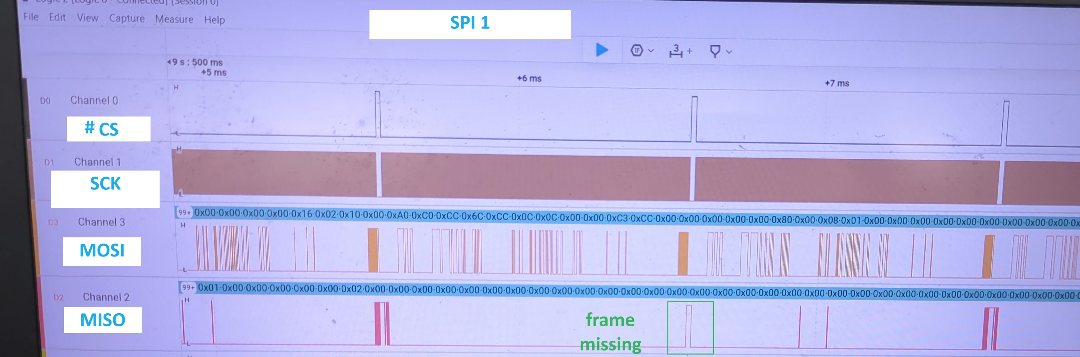

Hi Team,
Recently while working with STM32F072RB , I am using DMA mechanism with SPI. I am receiving a 63 bytes of data continuously from an external system at every 1ms.
In  STM32F072RB, I have enabled two SPI-SPI1 &SPI2. From/to the external system. I have to receive and transmit 63bytes of data simultaneously . I am receiving 63bytes of data in SPI1 and SPI2 happening with no shifting.
But coming to the transmit part for SPI1 and SPI2, I am getting 63 bytes of data(i.e. frame 1 ), but in byte shifting is happening in this 63 bytes. For example , frame 1's last byte(62nd index position) is coming as 1st byte in the Frame2(0th index position)(checked in logic analyser) .
I am using below function for both SPI's.
HAL_SPI_TransmitReceive_DMA(&hspi2, (uint8_t*) aTxLeftBuffer,
(uint8_t*) aRxLeftBuffer, 63);

    The CS pin time is 1 millisecond, during which I need to transmit and receive data from two SPI devices simultaneously.
    The problem I'm facing is a one-byte shift: the last byte of the first frame data is appearing as the first byte in the next frame. Additionally, some frames are being missed, resulting in data being received in alternate frames.

    I suspect it's an issue with the CS line. Can you show the issue on a logic analyzer?
    I see no code which manipulates CS, just code which waits for it to be toggled. How are those pins changing state?

    I am herewith attaching the snap shot of logic analyzer (for SPI 1). Similar for SPI2.
    Jul 29, 2024 1:40 PM UTC
    Apart from MISO, everything looks fine to the extent that I can see. Can't resolve detail around CS edges.
    If CS/SCK/MOSI signal are correct, nothing is wrong on the master/STM32 side.
    What external device are you interfacing with? Are you meeting all of its specifications for data transfer?

    In our application STM32 is SPI slave mode, Above is reference block diagram, attached above is SPI-1 and SPI-2 waveforms in previous chat
    Kindly guide as on Data transfer From Slave to master (MISO)
    We are getting alternate frame miss in MISO as you can see in above waveform snaps in previous chain
    As you mentioned CS/SCK/MOSI signal are correct, nothing is wrong on the master side -----> yes
    We are facing issue in slave (STM32F072) data transfer to Master device

    I think it's a program logic issue. You're starting SPI1 transfer when SPI1_CS is low. Surely that's too late. The slave needs to be ready prior to the start of the transaction. Typically, one would resynchronize/queue the data on the CS rising edge.
    Should also be monitoring for HAL return functions. My guess is you're not getting HAL_OK in all cases.
