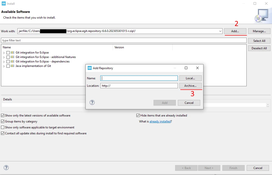

Do anyone know how to install the Egit plugin in an offline machine(Windows)?

    you can download the latest build of EGit from this web page (or this is the direct link). That is a copy of the update site packaged into a .zip file. You can use that zip file following these steps:
    1. Select the menu command "Help > Install New Software ..."
    2. Press Add button
    3. Press the Archive button
    4. Point at the zip file, select the features you want to install and follow the screen instructions

    Dear Stefano,
    It's good to see you here (again). I hope you're doing fine, and I thank you for providing me the detail solution.
