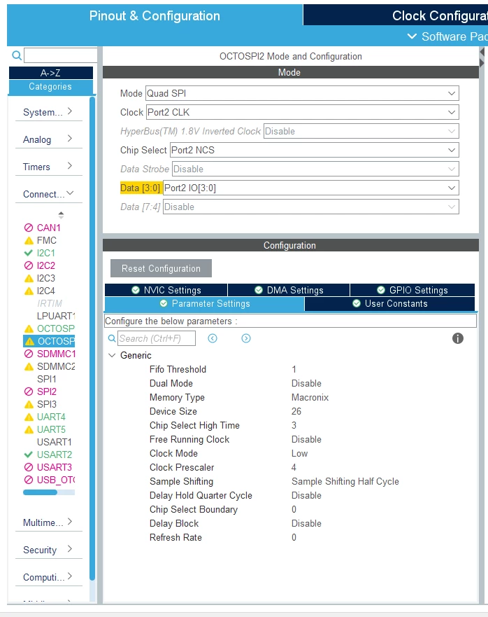

Octo-SPI external Flash - when i write to memory, when read after writing i get 0xFF
Hi, i have some issues with writing to external flash memory. Read status register etc works wel. Just writing to external memory gives me unexpected result.
I use the following MCU:  STM32L4P5ZGT6P, I use the following external flash memory: Macronix MX25L12833FMI-10G. Instead of using the complet octo-SPI, i use quad-spi,since my external flash only supports quad-spi and Single SPI. i SDR mode.
See attachement for the code(i have extrated the code from my program, all the necessary can be seen in the attachement).

    Tried to skim the code, bit overly cluttered
    Setting SR.QE (0x40) enables the 4-pin physical operation, not the command / address.
    I think you need to use 0x35 to switch into 4-bit command mode,or you can use the move verbose forms ie 1-1-4 or 1-4-4

    The function OctalWriteEnable makes use of the 0x35 command. So i use it.
