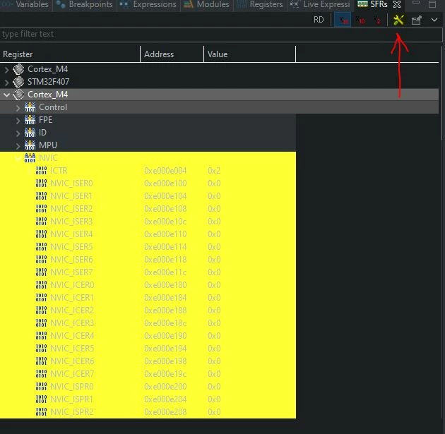

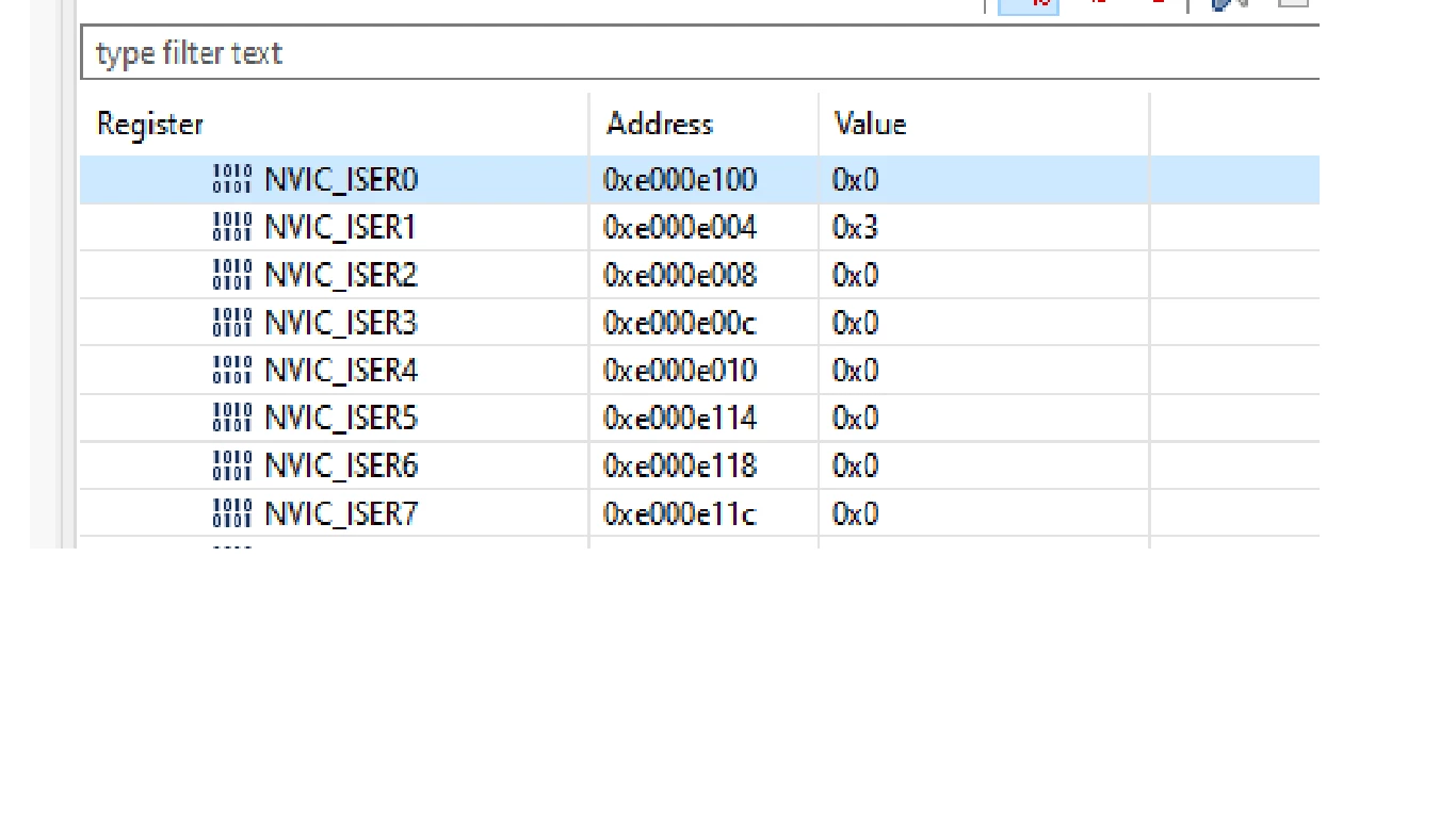

NVIC ISERx registers address are wrong in STM32F446RE
I am using STM32F446RE. I am using the STM32CubeIDE. As STM32F446RE is Cortex-M4 based processor I have also gone through the M4 generic user guide and found that the range of NVIC_ISER0- NVIC_ISER7 is 0xE000E100- 0xE000E11C. But when I ran the code in debug mode and go to the NVIC registers I see the below addresses.
0693W00000BaBsyQAF.pngCan I resolve this issue or is it hardware issue?
Can anyone help please

Now the address got changed but still not matching with the  M4 generic user guide ( NVIC_ISER0- NVIC_ISER7 --> 0xE000E100- 0xE000E11C)

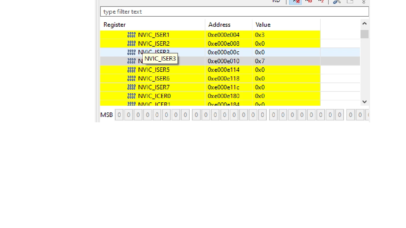

Yeah I copied correct file only. I checked the SVD file. Only ISER0, ISER1 and ISER2 are there. Others are not there. I also tried adding them manually. Still I see the same issue.
ISER0 -> 0xE000E100 .this is correct
but ISER1-4 are not correct here.
ISER1-> 0xE000E004
ISER2-> 0xE000E008
ISER3-> 0xE000E00C
ISER4-> 0xE000E010
Those should be 0xE000E104, 0xE000E108, 0xE000E10C and 0xE000E110 respectively

To explain: The SFR-view loads two svd-files. One for the core itself and one for the specific STM32 product describing its peripherals. See below each top-node represents an svd-file:
I think you checked the NVIC node inside the STM32F446 parent? Check inside the Cortex_M4 instead.

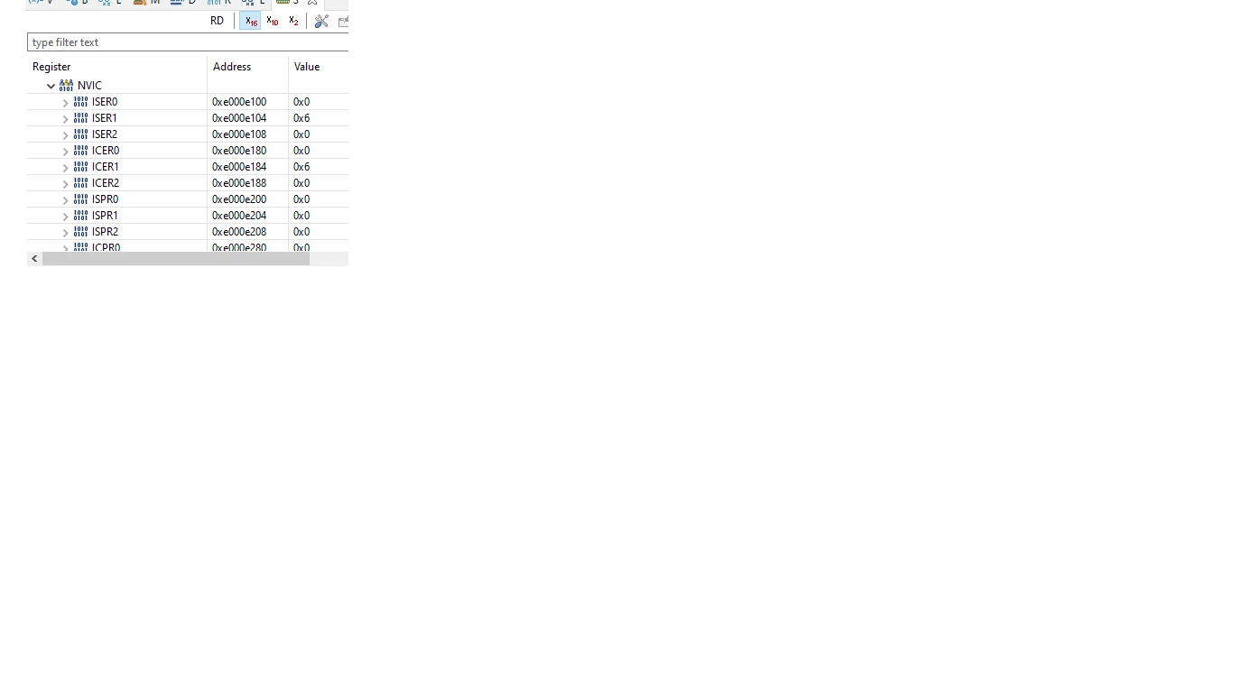

I got some temporary solution. Instead of checking the NVIC register in Cortex_M4 check into the microcontroller specific NVIC section. There the addresses are correct.
Ex. In my case:
0693W00000Bc6tqQAB.pngI see the below addresses which are correct. but here all the registers are not available

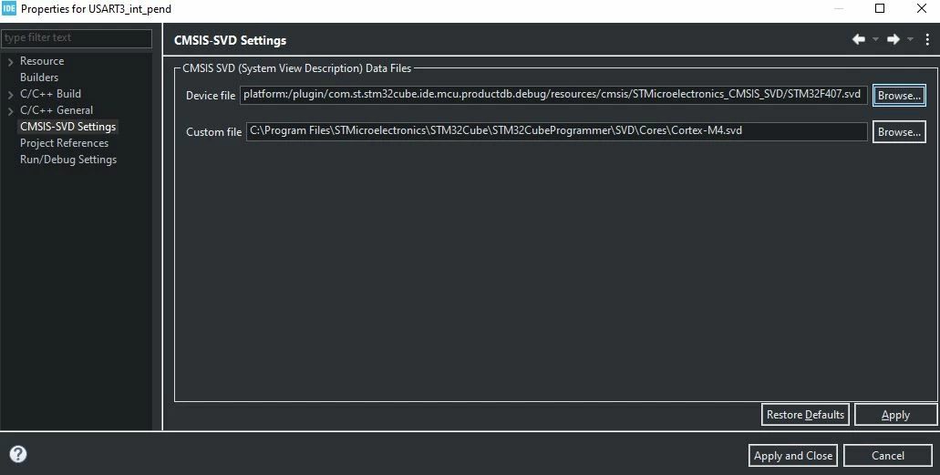

**I just opened Cortex-M4.svd file and searched NVIC ISER0 and ISER1 . I saw offset address are wrong "<addressOffset>0xFC</addressOffset>"
I changed it and ı debuged my code and I opened NVIC registers MAP. But guys over there you will see a tools change. U need use your customer svd file as a this file
where it is "C:\Program Files\STMicroelectronics\STM32Cube\STM32CubeProgrammer\SVD\Cores\Cortex-M4.svd"
here is how I changed:
