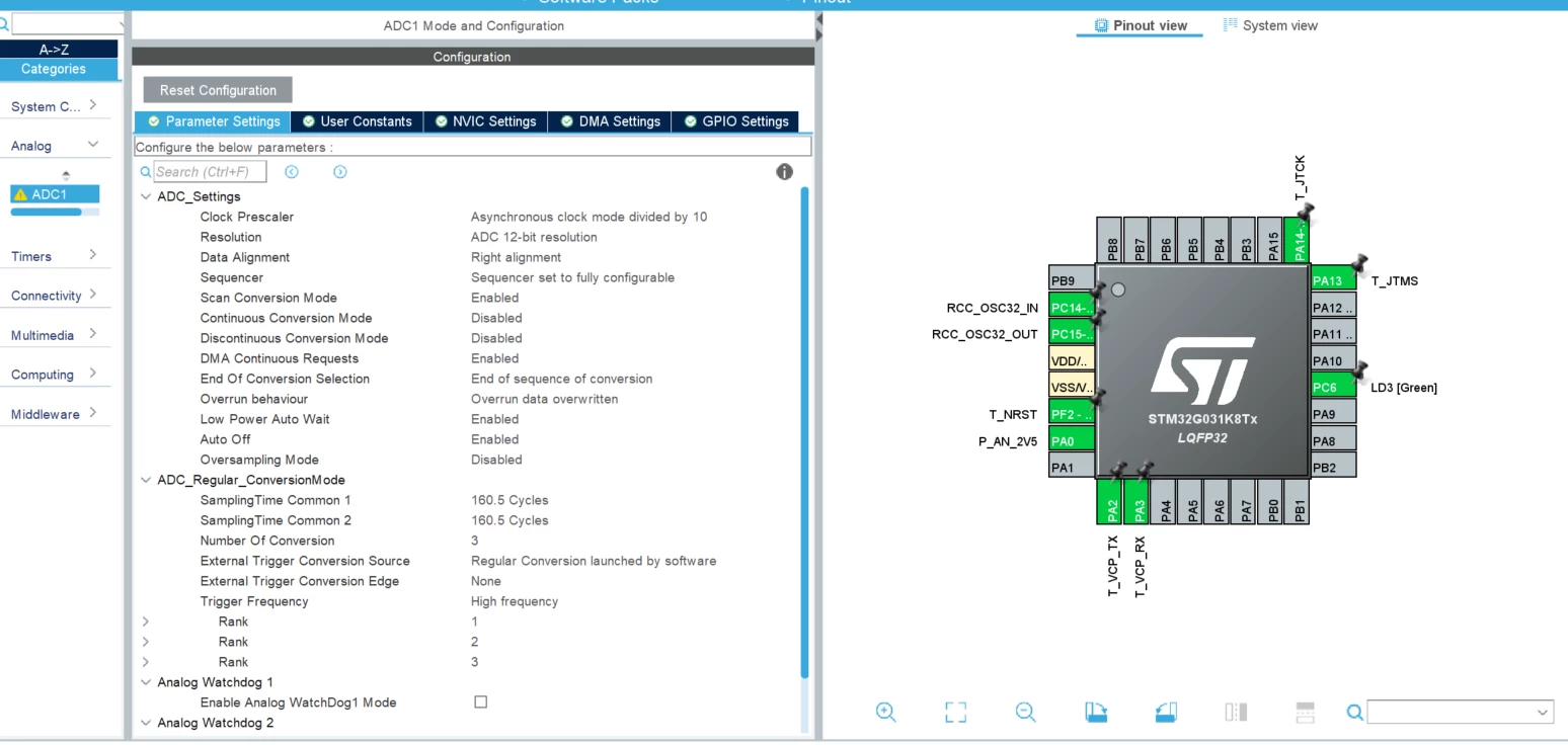

The configuration I made for the ADC via STM32CUBEIDE to NucleoG032k8 is as follows.
There are 3 channels. These are as follows;
rank1:PA0(2V VOLT)
rank2:Channel temperature sensor
rank3:Channel Vrefint

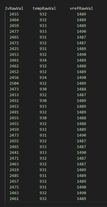

What is the reason why the raw value of 2 volts fluctuates so much?

Could be that the signal fluctuates that much. Could be that your VREF+ fluctuates. Could be a high impedance source.
General advice for improving ADC accuracy is here:
https://www.st.com/resource/en/application_note/an2834-how-to-optimize-the-adc-accuracy-in-the-stm32-mcus-stmicroelectronics.pdf
