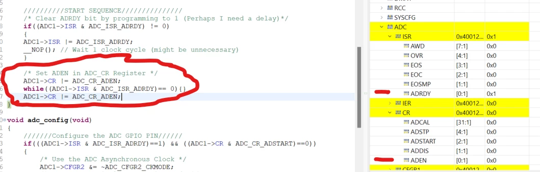

Nucleo-STM32f030 ADC setup Issues This code only works when I'm debugging step by step. Otherwise, it always sends ADEN low again, which should not happen!!
This code only works when I'm debugging step by step. Otherwise, it always sends ADEN low again, which should not happen!! (Correct sequence: ADEN goes high then ADRDY goes high and both stay high...) (Note both ADEN and ADRDY are low before line 54 of pa1_adc_init() function)

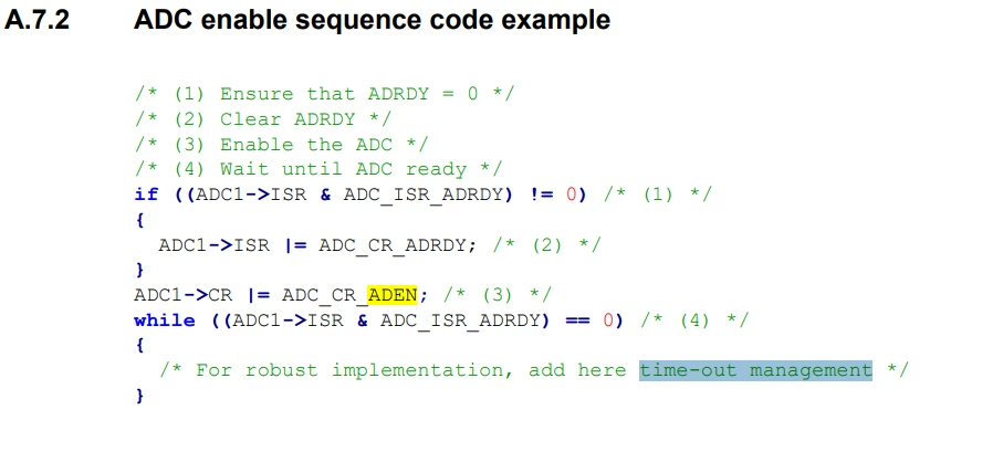

0693W00000YAXrPQAX.pngThe reference manual says...

The issue occurs on lines 56 and 57 of my pa1_adc_init () function below.

> while(!(ADC1->CR & ADC_CR_ADCAL)){
> __NOP(); // Wait and Do nothing
This is incorrect: as ADCAL is nonzero after setting it - calibration is ongoing - program never enters this loop and proceeds to enabling ADC through ADEN - and this fails, as hardware does not allow to set ADEN while calibration is ongoing.
Look at the example in RM, which is:
ADC1->CR |= ADC_CR_ADCAL; /* (4) */
while ((ADC1->CR & ADC_CR_ADCAL) != 0) /* (5) */
/* For robust implementation, add here time-out management */

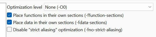

Are you using different Build settings for the two test scenario (the step by step debug and the Run).
Could you check the optimization level?

I am not using 2 different build settings for the 2 scenarios. In both I am using the debug perspective. The only difference is where I set the breakpoints. (Line 55 vs line 65)
My optimization level is set at the default (No optimization)
