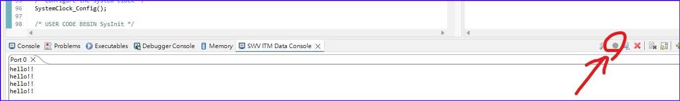

I would like to use SWV for debugging on the Nucleo-N657X0-Q board.
I first enabled SWV debugging and also change the CPU clock to 400 MHz.
Then, I added some code to main.c (as reference here ).
At the same time, I also set the core clock to 50 MHz in the TRACE configuration of Keil.
But i can't see any string in Debug Viewer.
Does anyone know what else I should check?

Hello @bioak and welcome to the community;
Have you encountered the same issue while using the STM32CubeIDE toolchain?
I recommend you to look at this post and get inspired to check the settings:
I hope this help you.

Jun 23, 2025 6:03 AM UTC
Hi KDJEM,
I made a silly mistake.
At first, I used CubeIDE, but I couldn’t see any messages in the Trace View window.
So I switched to Keil MDK to verify the output.
Now I can see the messages.
The reason I couldn’t see the printf messages in CubeIDE was that I hadn’t enabled Start Trace.
