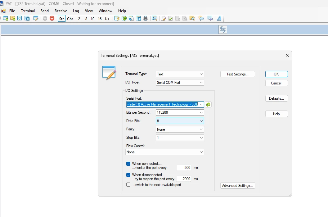

NUCLEO-L4R5ZI-P Printing gibberish on Serial
I just got a NUCLEO-L4R5ZI-P and trying to test it out before i start my project. I tried the simple "Hello!" on serial and displaying via PuTTY cmd on windows. It is printing gibberish or maybe am missing something. Am new to ST and any help will be appreciated. I have tried a number of solutions but same result. Here is the main.c code and the output on PuTTY cmd.

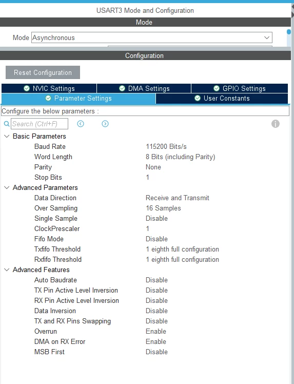

    The commonest reason for getting gibberish on a terminal is wrong baud rate:
    https://learn.sparkfun.com/tutorials/serial-communication/all#:~:text=If%20all%20the%20receiving%20device%20sees%20on%20its%20receive%20line%20is%20garbage%2C%20check%20to%20make%20sure%20the%20baud%20rates%20match%20up
    Check your clocking.
    Use an oscilloscope or logic analyser on the wire to see what the actual speed is.
    Odd_coderAuthor
    August 21, 2024
    is there another way of checking the baud rate without using the oscilloscope or logic analyzer?
    August 21, 2024
    you can check it in the ioc settings of the uart
    above is the settings that i used in the YAT software on PC
    this settings location may vary with different software
    you must have the same settings on the receiving software / uc as of the ioc settings
    If you are asking about physically finding out the baud rate i haven't done that so I have no idea.
    August 13, 2024
    Try using the software called YAT terminal, this have easy interface,
    Check whether the setting son both microcontroller and the terminal application are the same
    like Baud rate, Word length, Parity, Stop bits these should be same on both.
