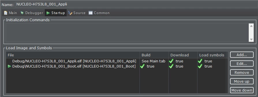

Hello, I have configured a project with CubeMX using a NUCLEO-H7S3L8 with an STM32H7S3L8 MCU.
Although everything works, I first need to flash the bootloader and then flash the application.
A reset is required to start the app.
Using the debugger, I confirmed that the app is running from an external flash drive (PC with a 0x9000000 value).
I'm missing the "Build All" option, which allows you to build all three projects simultaneously and start the application after flashing without having to press the reset button. I think so.
This is the first time I've used a bootflash MCU, and I'm sure I've missed something.

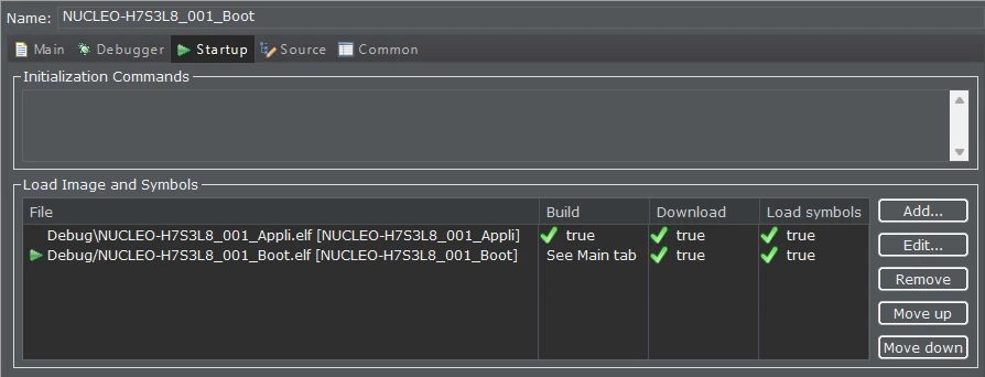

Regarding the need to press the reset button to launch the app, I've fixed that as well.
In the app's debug configuration, on the "Startup" tab, I had to add the bootloader.
Make sure they are in the correct order to avoid a hardfault when starting debugging, like shown below.
For the application it should look like this:
And for the bootloader it should look like this:
That was all folks, cheers, and happy debugging!
Solved.
