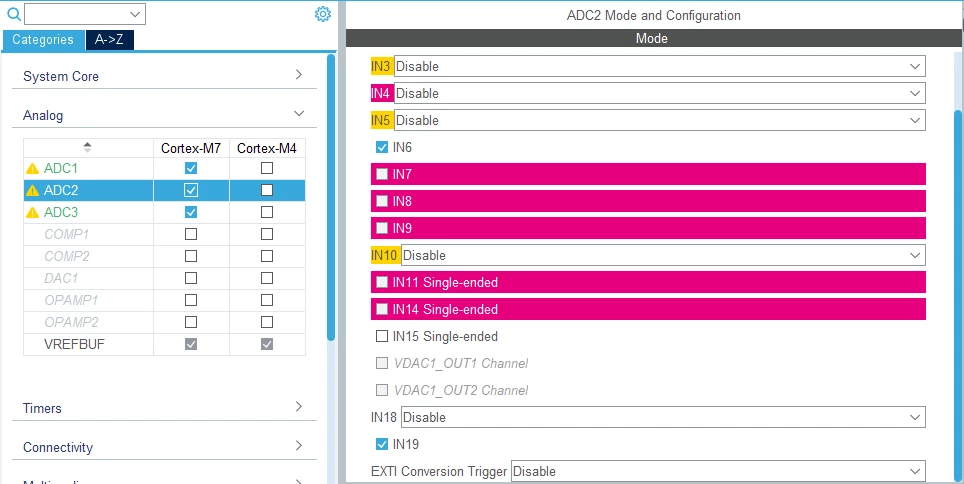

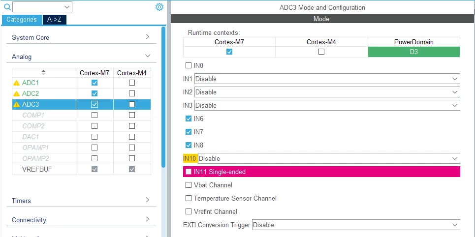

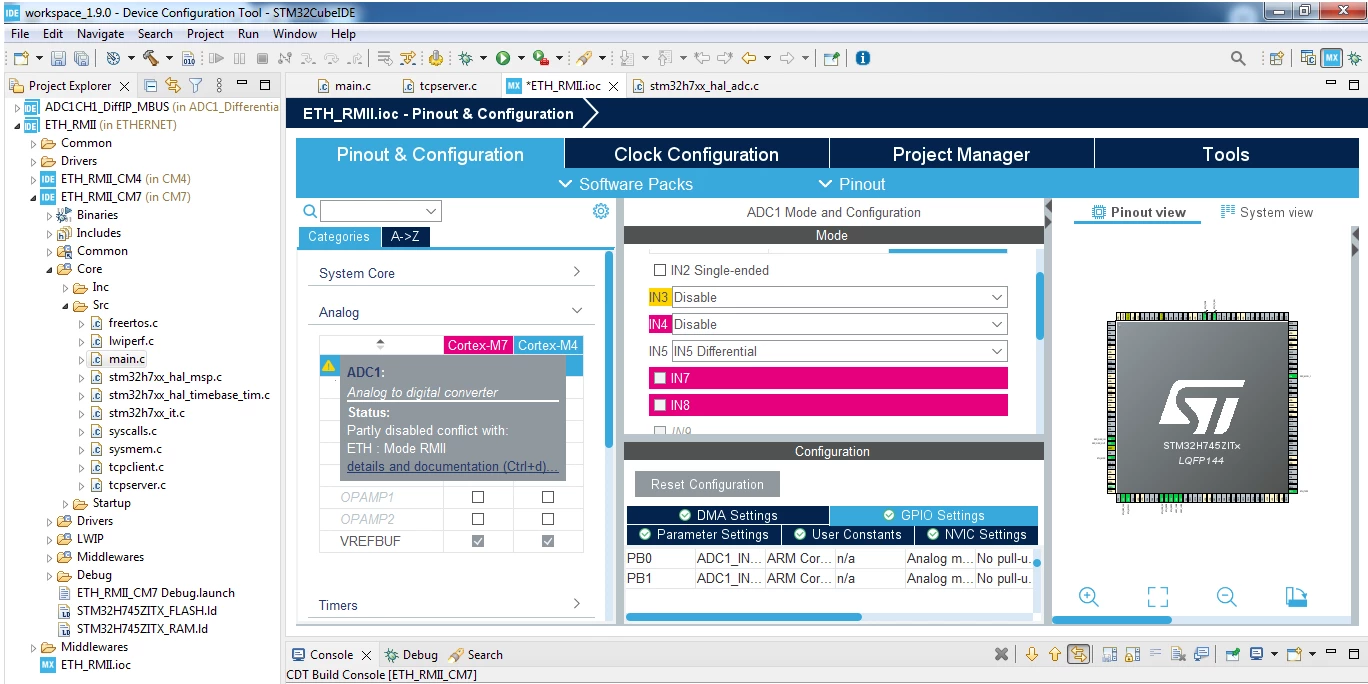

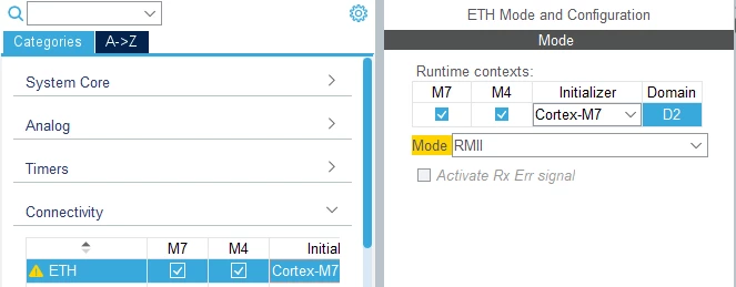

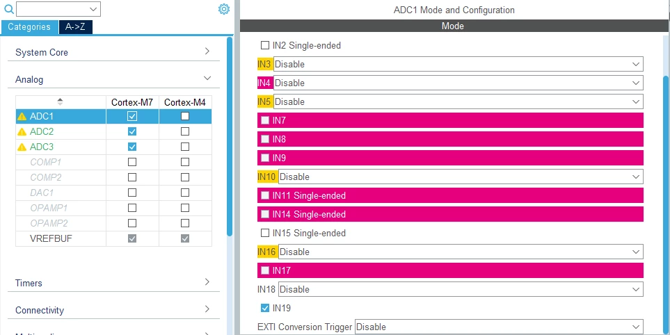

Hello i have a Nucleo H745ZI_Q board in this Ethernet is working fine but  when am going to configure ADC  all the three ADCs are shows error message --> Partly Disabled conflict with: ETH: mode RMII   even many channels also showing error message (i need  4-5 channels) i choose one  independent channel .In programing when  ADC initialization comes ethernet will not work .If comment the ADC  initialization ethernet is working fine . Whats the issue ?? How to resolve this ????

    I have used 6 ADC channels using 3 different ADCs as you can see her:
    and I've used the ethernet as you can see her:
    After that, I've builded le code and it shows no errors or warnings.

    Your using Single ended ADC right . In the same code your using Ethernet  in RMII mode .
    For ethernet your using FreeRTOS ?    or to ADC ?  is it possible to share your code ??
    in my case am using FreeRTOS for ethernet . And u using both the cores M7  and M4  why i didnt understand
