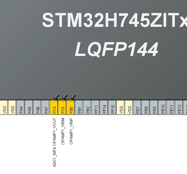

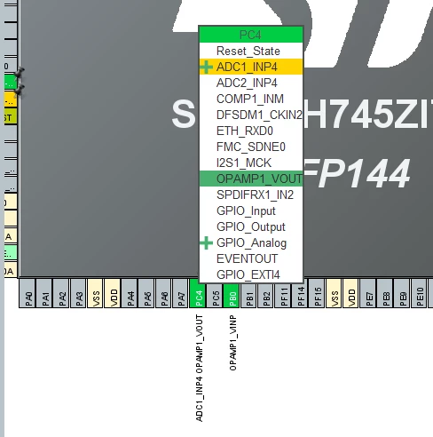

OPAMP1_VOUT is on pin PC4 and I can select ADC1_IN4, I think this should route the OPAMP output directly to the ADC?
Within IOC if I select OPAMP1 I see PC4 has OPAMP1_VOUT in green and PB0 has OPAMP1_VINP in green.
Moving to ADC1 I can select IN4 as OPAMP1 Output Single-ended and that appears in yellow under the pin allocations.

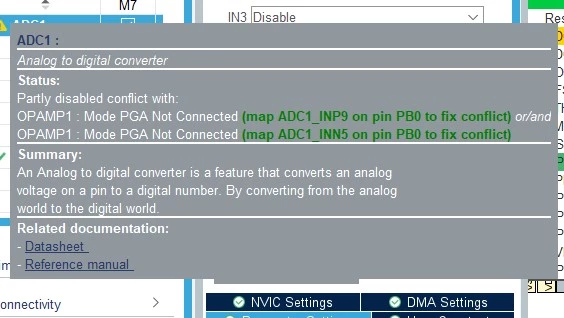

ADC1 still shows a yellow triangle.
It suggests the following to remove the yellow triangle:

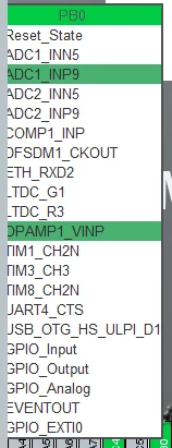

This seems to suggest that I should connect ADC1_INP9 to the same pin as the opamp input? That doesn’t seem correct to me. However if I do select that both are now highlighted in green

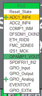

Yet the important one, PC4, OPAMP1_VOUT is green yet the ADC input, ADC_INP4, is still yellow?
In summary I think this is a question in two parts, how do I connect the OPAMP1_VOUT to ADC_INP4?

1°) To be able to configure the OPAMP1 and ADC1, you must first configure the GPIOs in the Pinout View.
Right Clic on PC4 and choose OPAMP1_VOUT.
Right Clic again PC4, then press Ctrl and choose ADC1_INP4.
Right Clic on PC5 and choose OPAMP1_VINM.
Right Clic on PB0 and choose OPAMP1_VINP.
2)° Then select ADC1, enable Cortex-M7 (or M4)
Enable IN4 Single-ended, PC4 change from yellow to green.
3°) Then select OPAMP1, mode PGA Connected-INVERTINGINPUT_IO0.
PC5 and PB0 change from yellow to green.
4°) Finish the configuration of ADC1 and OPAMP1 according to your application.

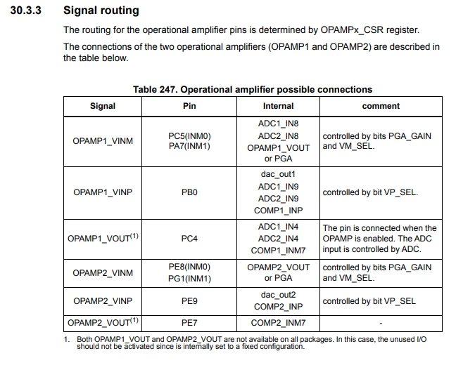

I'm referring to RM0399 Rev4, chapter 30.3.4 OPAMP modes.
If you want to use OPAMP1 in Programmable gain amplifier (internal PGA) mode, in STM32CubeMx you should select OPAMP1 Mode = PGA Connected-INVERTINGINPUT_IO0.
In this case, the programmable gain is 2, 4, 8 or 16 (OPAMP1 Parameter Settings Tab)
This configuration will expose the following GPIO assignment.
PC4: OPAMP1_VOUT
PC5: OPAMP1_VINM (must be left unconnected as the PGA is internal and where the resistor bridge is referenced to VSSA, see Figure 228 in RM0399 )
PB0: OPAMP1_VINP, connected to your microphone (referenced to VSSA)
